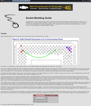

mods:
http://www.geocities.ws/tuacubx/reads/MSMG.htm
273.14 KiB
1493 views
uploaded pic incase link goes down ( the "here" link is already dead)
some of the described mods require severing the connection between the processor and motherboard. so it seems that a interposer or a t least cutting the cpu pins will be required. bummer.
Desired features list:
-pwrgood bridge switch
-interrupt the two pins DYN_OE, and RESET2# (these prevent tualatin from working on older mobos)
-Interrupt and intercept the Vid pins, give switches for them to be pulled to VSS in order to manually select desired voltages.

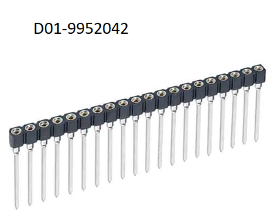

anyone have a line on LIF or interstitial sockets for this?
one possible solution is to use a sacrificial cpu to harvest pins from.
I could make a pcb that you push onto the donor cpu. heat it up then pull all the pins off as they are. then put the tweaker on it and melt them down. But that's obviously some highly skilled work.
then the socket could be smd soldered to the top..
it's possible, but I hate this design. too much to go wrong, too hard to build. need a better solution.
I looked around for LIF sockets but for some reason don't see any. it may be possible to make it out of rows of LIF pins though
I see that they did exist at some point:

Reply 3 of 11, by Sphere478
this seems like a good solution to the problem. push them onto a cpu. put into tweaker and solder them down.
The pin, top sockets, and lead lengths look like they will work. Also, being in rows may help when soldering (one row at a time).

Reply 5 of 11, by Sphere478
PARKE wrote on 2022-06-21, 12:43:
But those thingy's go for 5 bucks a piece ?..... can't you better buy complete sockets, like this:
https://www.baypatients.space/archive/1pc-518 … nktllsrmnq.html
Well, I was looking for one of those but couldn’t find one for sale in my searches. That doesn’t appear to be the correct layout for socket 370 btw.
Each one would need two. Also I need to get one or find a datasheet for it to confirm the pin and socket tolerances.

Reply 6 of 11, by PARKE
Sphere478 wrote on 2022-06-21, 13:50:
The photo's on that site are skewed, you can see the real dimensions here:
https://www.ebay.com/itm/223091187236
edit: spec sheet
https://www.mill-max.com/products/datasheet/s … 3-370-69-129808
