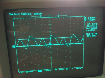

The first step was to figure out a way to double the frequency. I found a nice article that used a comparator and XOR gate to achieve this, and adapted it to the frequency I needed. After a lot of experimenting, it turned out not to work too well, as the comparator used was not fast enough to output a proper square wave, but a sine instead. After a lot of tuning I managed to get the circuit to work kindof alright; it outputs a 66MHz sine out of a 33MHz clock, but the peaks are not perfectly symmetrical.

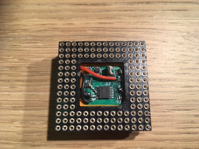

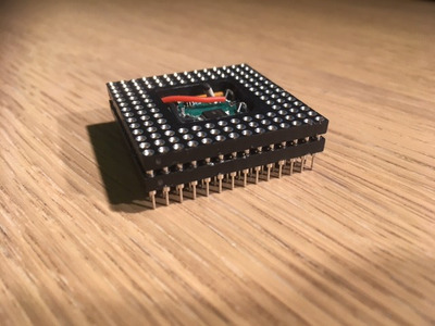

The second step was to jam it into an interposer. I cut the pin carrying CLK2, connected it to the circuit, and feed it back into the top socket.

The attachment IMG_3792.JPG is no longer available

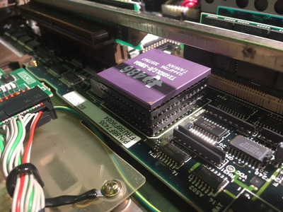

On this goes the TI486DLC, and the whole contraption goes into the motherboard:
The attachment IMG_3794.JPG is no longer available
But this is where the fun ends. The computer doesn't post. The processor does get warm, so it at least gets power, but there is no output on the screen. When I removed the interposer and reinserted the CPU directly it again came up happily.
So, it just doesn't work. Question is why. I see two options:
1. It could work, but I didn't do it right. Maybe the 66MHz I generate doesn't have the right flanks/uptime etc.
2.There is some fundamental reason it doesn't work. Perhaps clock doubling requires some sort of buffering to interact with the rest of the system, e.g. sending the 'ready' signal only every other pulse.
Curious to hear your thoughts!

I can think of 2 plausible reasons
1. The square wave, which is not square. This could however as well be an issue with your scope, though.
2. Doubling the clock on the clock in will also result in address/data activity derived from the higher clock, thus not being in sync with anything else on the motherboard.

Reply 3 of 12, by Blavius
Unfortunately I didn't take a picture of the original waveform, but it was not a square wave but a rounded off triangle, almost a sine. For this reason I added a second comparator to try to make the circuit work with the RC time delay. Unfortunately this did nothing as the output of the comparator is also almost a sine at this frequency. The XOR gate is fast enough though, and with the time delay caused by the gate and some tweaking of the comparator threshold voltages I got the result shared above. As the 66MHz flank coincides with the clock flank I figured it would be good enough.

Reply 9 of 12, by Tiido
The system must use same clock as CPU receives, almost all signals that the chipset need are synchronous to CPU clock. So what was done will never work, the rest of the system needs the higher clock also.
Reply 10 of 12, by rasz_pl
Tiido wrote on 2022-09-04, 20:01:
this, if anything find the source of CPU clock (you said 33mhz generator) and replace it by inject faster clock there
