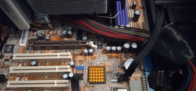

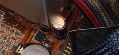

tfw (my forum profile pic) when you get a gcard and there are 2 capacitors that are too tall blocking it, stoping it going into the AGP slot.
I couldn't find any AGP risers for sale.
I've got no choice to take it all out, unsolder those 2 and to buy hard caps that are shorter and soldering those in, don't I?

mockingbird wrote on 2022-10-03, 13:53:
Desolder them both. Attach some wire to the leads and then put them wherever you want. Don't use too long a wire, you are increasing the ESR by doing this.
hmm, thanks for the tip, will do tonight when I get home.

derpmochump wrote on 2022-10-03, 15:33:
the electrical store as already closed at 4pm 🤣.
so i need tinned copper wire right? what size?
Any wire will do, stranded, solid... Have you desoldered capacitors from motherboards before? It won't be easy, and there's a chance of destroying the pad on the underside of the board or ripping out the via.

cut off resistor legs will be perfect, but as mockingbird said as short as possible. I could see them just leaning at 45 degree over the battery holder, and dont mix polarity by accident
aaand dont drill the holes 😀 if you have trouble cleaning hole from solder either use stel hypo needle, or just add more solder and push resistor leg into the hole while melting it, then cut the leg to match desired length.

if you have enough space you could lay the capacitors down on their sides with the legs bent 90 degrees to go down into the board. I've done this before and manufactures occasionally do this to solve for height restrictions.

Just order new caps they come with long leads.

Don't know why you'd cut up the card's cooler when you can just put new capacitors on the board with the legs folded over at a 90-deg angle.. When I can't fit my car in the garage because my son put his toys in my parking spot, I don't cut a hole through the garage door so it closes.

I'm waiting on caps to come from china, still haven't arrived.
