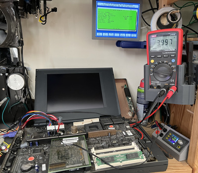

Reply 15 of 152, by Thermalwrong
Huh, I didn't realise that multiple Blue Lightning CPU upgrade boards used the AMS1117. It probably requires using the PCB's copper and the SMD mounting to dissipate heat.
I think the LT1085CT was picked on mine for lack of cooling since a 7.5 amp linear regulator is quite over-rated for a CPU that's kind of suited towards mobile use.
I can try out my BL3 board and check the voltage tomorrow if it could help.
For the PCB design if that's an option (I think that's better than modifying the existing board, personally) - just copying one of the better adapters would probably be best if it doesn't require glue logic and hopefully isn't 4 layer.
And well, if it is 4 layer or more layers, that's possible to copy too, just destructively unless you have an x-ray setup handy.
Reply 16 of 152, by Sphere478
We can probably extrapolate a passive interposer using pinout for the socket and datasheet for the chip even if the oem are 4 layer
Sphere's PCB projects.
Reply 17 of 152, by Thermalwrong
Pulled it out and plugged it back into the test setup briefly, it does run at 4 volts 😀
