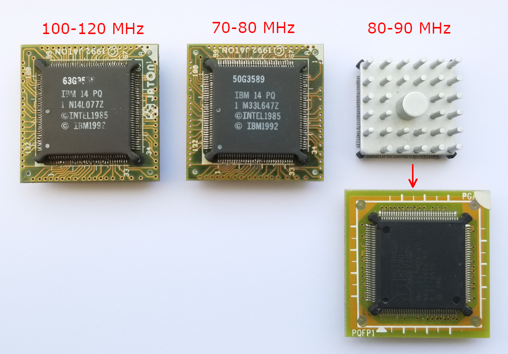

Probably the final chapter, for now at least, of my fastest 386 PC adventure - the IBM Blue Lighting 3 storyline.
It started on page 1 of this thread with PC-Chips M321 rev 2.3 motherboard and Am386DX-40 CPU.
Went through a lot of 386 mobos, including PCBs like Alaris Leopard and Cougar to finally settle on DTK PEM-4036Y with TI SXL2-50 CPU.
Along the way experimented with few IBM BL3 CPUs on weird adapter cards which never worked quite right, or at all, especially on fast motherboards.
This was very annoying because the BL3 chips scale much better than SXL2-50.
... until recently ...
It turns-out that IBM BL3 is pin compatible with 386DX.
Yes.
All these BL2/BL3 adapters made the whole upgrade thing a big mystery, to me at least.
I perceived the additional components and circuitry on them as a major incompatibility on electrical and signal level between 386 and BL3 chips.
So, never tried to plop a BL3 CPU on one of those QFP adapters. It felt ridiculous.
But in a unexpected turn of events i acquired such combo and surprise surprise - it worked.
Not only that, but it worked on the fast 386 motherboards and especially on that DTK PEM-4036Y.
Tried the same mod on two more BL3 chips - worked too.
Along the way noticed that BL3 chips scalability varies widely compared to the overall uniformity of Amd 386DX, Cyrix 486 DLC-40 and TI SXL2-50.
Image shows two of the chips modded in place already with a third one to go under the soldering iron on another donor adapter soon.
Included the frequency ranges of each chip.

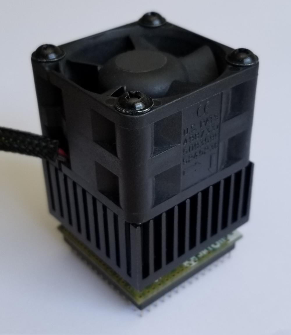

The best one got heatsink and fan strapped on top:
EDIT:
After series of grueling stability tests it was determined that air cooling can eventually fail when the ambient temperature is high enough (hot summer day).
Active cooling had to be applied. Used the same approach for getting the 486 processors long-term stable at 180/200MHz.
Fan, heatsink, 5V Peltier element, 2 layers of insulation for water condensation (foam on the inside + melted plastic on the outside), the CPU + adapter, custom 3D printed bracket.
Easy to disassemble, but very sturdy when strapped on.

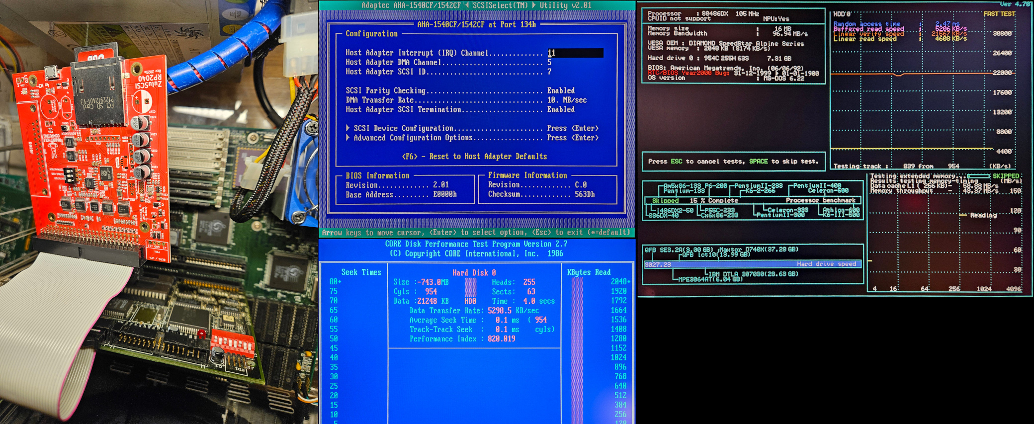

Speedsys with the IDE controller listed above:
And with Adaptec AHA-1542CF with ZuluSCSI adapter:

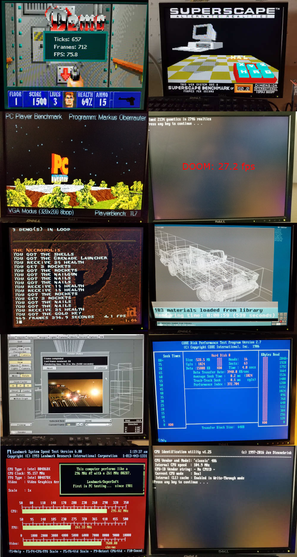

The usual set of tests.
DTK PEM + CL GD5343 + SXL2 at 50MHz (1x50) and ISA bus at 25MHz
DTK PEM + CL GD5343 + BL3 at 100MHz (2x50) and ISA bus at 25MHz <- !
Alaris Leopard with BL2 at 80MHz (2x40), Ark1000VL in DOS and S3 Trio64 in Windows
Alaris Cougar with BL3 at 100MHz (3x33, quite unstable) and 75MHz (3x25), Ark1000VL in DOS and S3 Trio64 in Windows
* Gray bars indicate not fully stable system.
The Cougar board is a bit faster in Wolf3D, also leads by quite a bit in WinTune2 (Windows GUI) because of the S3 Trio 64 accelerator.
But other than that DTK PEM + BL3 is where things happen.

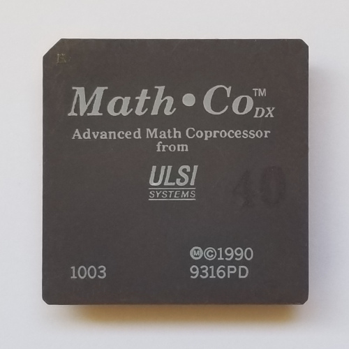

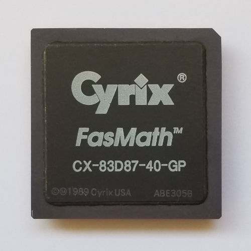

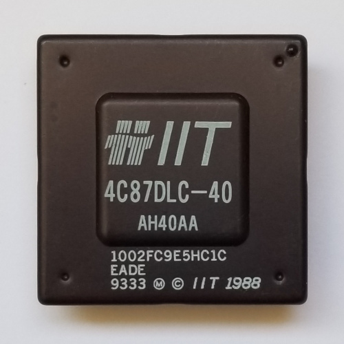

It became evident that the used until this point Cyrix FasMath CX-83D87-40-GP co-processor was not stable enough anymore - can hang the system in some of the complex computation tests.
Started searching for a replacement.
33MHz CPUs don't light-up at 50MHz frequency. This limited the scope to 40MHz rated ones. These guys:
fpu_387_cyrix_fasmath_40.jpgfpu_387_iit_4c87dlc_40.jpgfpu_387_ulsi_mathco_dx_40.jpgfpu_387_ulsi_dx_dlc_40.jpg
After a lot of testing it was determined that ULSI DX/DLC 40 fits the bill.
There were some interesting learnings along the way.
1. Stability with IBM BL3:
- ULSI Math.Co DX 40 is even less stable than Cyrix Fasmath 40. I have 2 of these ULSI FPUs and the statement applies to both of them.
- Cyrix Fasmath 40 is not fully stable with IBM BL3 (which caused this investigation in the first place).
- IIT's FPU is fully stable.
- ULSI DX/DLC 40 is fully stable.
2. Performance (consistent, relatively, with Am386DX / TI SXL2-50 / IBM BL3):
- The IIT FPU is slower than the rest in all tests and by quite a lot. This was unexpected.
- Cyrix FasMath and the two ULSI FPUs are on par in all tests ...
- ... but in Quake 1 ULSI DX/DLC pulls ahead. FasMath produces 3.9 fps ULSI DX/DLC pushes it to 4.1 fps. This effectively makes it a better option than Cyrix FasMath for 386 class systems.

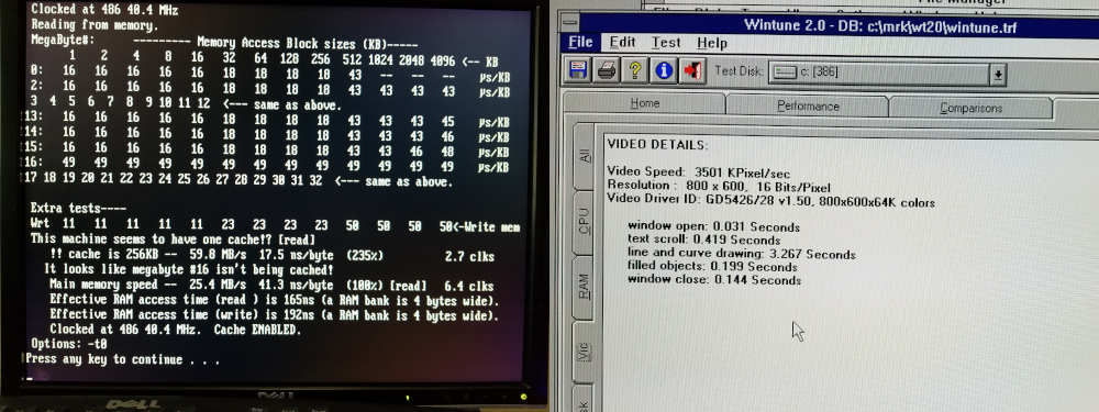

Couple of screenshots:
Quick roll captured on video.
(perf was further improved after capturing the video - numbers reflected in the screenshots above)
Notice that there is a discrepancy in the shown performance numbers between the benchmarks chart above and the screenshots/video.
The reason is that initially i used the REVTO486.SYS driver (screenshots/video).
Later on realized that LIGHT486.SYS + CTCHIP34.EXE produce better results in some tests without any side effects (benchmarks chart).

You removed the ISSI 12 ns 256K L2 on the MB in favour of Winbond 10 ns rated L2. Were both the ISSI and Winbonds of the Chinese reproduction variety? Does this offer any reassurance that the Chinese fake modules may indeed be 10 ns ?
It is kind of a shame that your DTK Symphony Haydn based board doesn't have VLB slots. Adding VLB to the BL3 adds nice flavour and should greatly improve video response.
Any chance that putting your Jaton BL3 (the piece that runs at 2x50) onto your Alaris Cougar board would let it run stable at 3x33?
Between the Leapord and the Cougar, the Cougar looks faster. Any chance the Cougar would run at 2x40?
I'll also be testing such contraption in the months to come. Probably when summer concludes.

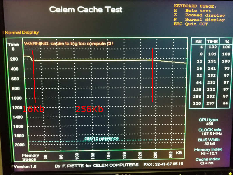

Could you provide a cachechk or speedsys image to demonstrate that L1 cache is working? I was also wondering if you tested for DMA issues using sound or floppy access?
I was thinking about the voltage issue some. There are 14 Vcc pins on the 132-PQFP package: http://datasheets.chipdb.org/AMD/386/386SX/21020A.pdf ,
however in looking at the Jaton photos, I only see pins 22, 49, 58, and 99 actually have a trace coming out of them. I bet we could use a small VRM like this EZ1117

About Functioning L1/L2 caches:
They do work as expected, which was the biggest concern initially, but turned-out well. Satisfied with the outcome.
SpeedSys never worked on that DTK motherboard for some reason. Providing CCM screenshot which shows similar graphic representation of the mem perf.

Anyway, motivated by Pshipkov’s awesome 486 Quake score of 22.7 I wanted to double check my bios settings to see if I had left anything on the table. I’m able to consistently bench at 22.6 but discovered I can hit 22.7 if I flip the L1 cache mode with the TweakBios tool. It’s a bit odd as TweakBios detects I’ve got L1 set to WT. To achieve 22.7 I have to change the setting to WB, save, and change it back to WT, and save. Then bam, consistent 22.7 scores in Quake Dosbench.
First off all, what is happening here exactly?
Secondly, what’s the likelihood we could determine the bios setting the TweakBios tool is setting and mod it into the actual bios? This is on the MSI-4144 board which currently has no settings in the bios to adjust L1.

Reply 1195 of 2379, by Chadti99
Yes the system is quite stable, this is the same 200MHz AMD 5x86 rig I left off. I’ve managed to find a 32MB module with the same Micron chips this MSI board seems to prefer and it has really knocked out the inconsistent boot stability I was seeing.
I spent maybe an hour flipping the settings back and forth in the TweakBios tool before I figured out what was giving me that extra 0.1fps. I’ve also since discovered I can hit 22.7 without using the Tweak tool but it’s rare.
I’ve ran through the other usual tests and nothing besides Quake benefits, Speedsys and CacheCHK report the exact same memory speeds from previous numbers I’ve reported.
I’m hoping @feipoa might find some time to add the L1 cache write setting into the bios setup menu. Or perhaps give me some guidance.
