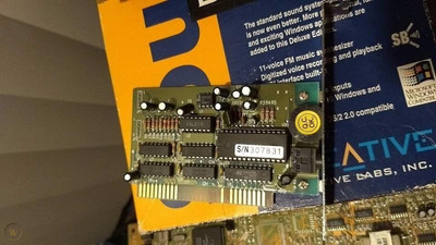

is it really J5QMF-001? worthpoint archived Ebay picture of "ADLIB CLONE CARD J5QMF-001" and it uses 14 pin DAC/28pin YM3812 just like Master Boomer:
The attachment adlib-clone-card-j5qmf-001_1_86f691ac20ac40fd19e112cc3f2f563b.jpg is no longer available
looks like maybe less advanced/cost optimized earlier version?
https://www.vogons.org/thumbs/35901_2b4d1345409a8236f4cbec2b0cd33087/adlib-clone-card-j5qmf-001_1_86f691ac20ac40fd19e112cc3f2f56 […]
I have one of those, the ebay seller I got it from said it was a "Sun Moon Star Adlib clone". I'm guessing thats the computer it came out of, I know they made 286 & 386 computers.
Mine didnt have a sticker on it but I see @ https://collection.batyra.pl/soundcards/adlib … e2#&gid=1&pid=1 that one has a sticker that says MF-001 though all the other ones I have seen are like mine without the JP1 & JP2 pins and without any kind of label at all. Only the FCC visible on the pcb.
Reply 17 of 17, by misi77
Here is a photo of the card in my collection (J5QMF-001):
