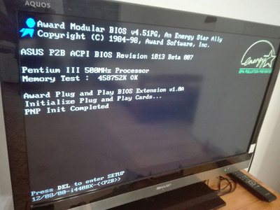

What file to use to update? I have version from attachment.
ooooooooooooooooooooooooooooooooooooooooooooooooooooooooooooo
note:
LM 75/78 describes the Hardware Monitoring feature
If the right pane with the fan speed, temperature and voltage control appear
in the power management on the bios setup, so you have the LM75/78 hardware
monitoring feature and should update with the appropriate bios.
If not, you don't have the feature.
ASUS removed it from some new boards to reduce costs.
Ok, that explains a lot however I have no idea what flasher to use because that isn't bin file only 000. 😀
ASUS still has these BIOSes (click "Show All" to see the rest) on their website. It also has the Aflash BIOS tool.
Thanks a lot guys, that helps, now I'm gonna find any spare FDD and update BIOS from that BETA. 😁
EDIT: BIOS updated, all works. 😀 Still BETA tho.
Yes, even if it puts beta, it is the last stable one there is.
That P2B v1.12 motherboard is a gem. Take care of her.
In case anyone else has this question...if you look at the pdf manual that asus still has up for this board on their website, they point out where the chip is/would be on the motherboard (for the monitoring feature).
Then flash the bios accordingly. Everything is still on the asus website (which is awesome and much appreciated).
