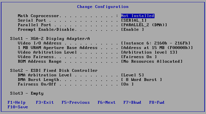

Reply 22 of 35, by SSTV2
I tried emulating an ESDI controller instead of SCSI, but the XGA-2 BIOS still wouldn't get resources allocated, for some reason you're not even allowed to change the ROM address range. However, I noticed one discrepancy when changing the address range of the SCSI ROM - it gets assigned 8000H (32KB) and the next range setting partially overlaps the previous one. For example, the first range is C0000-C7FFF, followed by C4000-CBFFF, obviously two separate devices with such resource settings would conflict with each other.
The total memory range that can be allocated to devices on an IBM PS/2 80 (if I'm not mistaken) and in my case an IBM PS/2 90 is 128KB (C0000-DFFFF), so only 4 devices can realistically be configured on an 86Box without conflicts.
On my Model 90, the ROM address range can be changed in 2000H (8KB) increments, starting with C0000 and ending with DFFFF, making the following ranges possible:
C0000-C1FFF
C2000-C3FFF
C4000-C5FFF
C6000-C7FFF
C8000-C9FFF
CA000-CBFFF
CC000-CDFFF
CE000-CFFFF
D0000-D1FFF
D2000-D3FFF
D4000-D5FFF
D6000-D7FFF
D8000-D9FFF
DA000-DBFFF
DC000-DDFFF
DE000-DFFFF
And judging by the MMaximus example, his Model 80 is also able to allocate 8KB space for an XGA-2 ROM at least.
Hope this helps.
*EDIT
In the SCSI adapter case on an emulated Model 80, addresses are allocated OK if the ROM size is actually 32KB. On my Model 90 no resources are allocated for the SCSI ROM and XGA/XGA-2, and the token ring adapter ROMs are getting allocated 8KB memory each.*

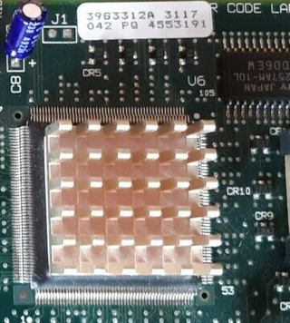

Reply 24 of 35, by mattw
actually, in my previous post I am talking total nonsense in my reply to @MMaximus, because still there is no connection in my brain to our latest finding about Index 53H and xga2 info tool DMQS output:
Re: Help anyone with IBM PS2 and XGA card on MCA bus
So, based on @MMaximus logs :
the card is:
       5 - XGA implementation function level identifier
3 - XGA implementation resolution level identifier
which means "53H=0x53", i.e. the same 90Mhz DAC revision as the one @SSTV2 has. Now, as I am no PS/2 expert, but based on what I read:
* the longer cards are XGA-1, i.e. they have to be "53H=0x30"
* then there are 3 types of shorter cards, all XGA-2, but have differently looking DAC:
- with Heatsink
- without Heatsink and white sticker instead
- Blueish in color
cut and attach pictures of all those types (the Blue one resolution is terrible, but still you can make out that it's blue color). So, at least one of them I expect to be "53H=0x50", i.e. 45Mhz, but who knows maybe XGA-2 with 45Mhz DAC was never publicly released and they are all "53H=0x53".
    62.26 KiB
    632 views
    190.5 KiB
    632 views
    220.04 KiB
    632 views
Reply 25 of 35, by mattw
@MMaximus and @SSTV2 : just out curiosity how the DAC chip looks on your cards from the above 3 options - maybe we can at least in the end of 2022, almost 2023 tell, how at least some of 90MHz DACs are looking, as you both have cards with 90MHz DAC for sure.
Reply 26 of 35, by SSTV2
You probably have already noticed what XGA-2 adapter I have from this post, but to make sure there are no doubts - it's the first revision with a heatsinked RAMDAC (part number should be 33G0327ESD)
I have dumped the first 8KB of the UMA's C segment, where the XGA-2 BIOS is mapped on my machine. Its contents exactly match the beginning of this XGA-2 BIOS image, maybe it'll help in the future:
XGA-2_C0000-C1FFF.zip
5.39 KiB
26 downloads
mattw wrote on 2022-12-28, 16:10:
but maybe that's why DMQS fails - we already know based on your tests DMQS is auto-disabled by the BIOS in case of XGA-1 card (which is correct because XGA-1 just doesn't support DMQS), but maybe when XGA-2 is not properly initialized by the BIOS (due to 86box bug), then that results in no DMQS. So, I think those issues very likely are related.
It has to be it, XGA-2 adapter simply isn't properly configured by the emulator.
Reply 27 of 35, by mattw
SSTV2 wrote on 2022-12-29, 18:57:
I don't know which one is the 1st revision and so here I count on your good knowledge about PS/2, but then it means even the 1st XGA-2 is 90MHz RAMDAC, i.e. "Index 53H=0x53", I guess that means there are no "Index 53H=0x50" (45MHz RAMDAC) XGA-2 cards.
thanks, that confirms your card is using the same XGA-2 BIOS, it's good we know that.
I am looking at that, but still have no idea...

Reply 29 of 35, by mattw
MMaximus wrote on 2022-12-29, 20:20:
I don't have access to my machine at the moment but I bought my XGA adapter from WBST on amibay a few years ago. Here is the archived thread - you might be able to get more info about the adapter from the picture
same as @SSTV2, i.e. "RAMDAC with Heatsink". according to @SSTV2 those are the 1st revision of XGA-2 cards, which means there are no XGA-2 cards with "Index 53H=0x50", even the 1st one were with 90MHz RAMDAC, which is quite nice actually.
