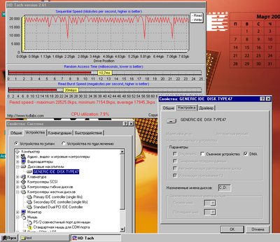

Reply 10 of 20, by Roman555
Gmlb256 wrote on 2022-12-28, 13:36:
Windows 98 didn't come with IDE drivers for VIA chipsets out of the box. 😖
But what about "Standard IDE driver" ? IMO it's enough for this case
P.S. A good Phil's explanation how to change dma mode in bios settings
How to enable DMA mode in Windows 95 or 98
    8.15 KiB
    257 views

Reply 15 of 20, by Roman555
Gmlb256 wrote on 2022-12-28, 15:22:
Roman555 wrote on 2022-12-28, 14:47:
But what about "Standard IDE driver" ? IMO it's enough for this case […]
Doesn't work with every motherboard chipset and PIO mode will be forced on unsupported ones in Windows.
But it worth to try. My Win95 on DFI MVP3 system (VT82C596 + 80-wire IDE cable + Samsung UDMA ATA66):
    217.19 KiB
    203 views

Reply 17 of 20, by Roman555
Gmlb256 wrote on 2022-12-28, 17:44:
Roman555 wrote on 2022-12-28, 17:36:
Ok, at least the VIA MVP3 chipset works with the generic IDE drivers supplied by Microsoft. So, it is indeed worth a try.
My apologies for doubting you.
The problem is I don't remember how I installed the drivers as it was years ago. So I'm not sure and maybe you are right. I will recheck
P.S. I've dig into VIA driver-install-software and found out there're two drivers: viavsd.inf and viaide.inf.
I can misinterpret my digging but it seems viavsd.inf relies on a microsoft standard driver mshdc.inf but viaide.inf relies on a VIA MPD driver.
So, Gmlb256, I apologize too. The VIA IDE driver seemed to be installed but it looks like in my system the microsoft standard driver works.
I was confused because VIA installed driver usually shows in Windows Device Manager "VIA Bus Master PCI IDE Controller" (not "Standard Dual PCI IDE Controller").
I don't know what utility can show which driver is working now. I've installed SiSoft Sandra 99 but it can't.
P.P.S. The via driver installer also copied vatapi.vxd , but I didn't find any links to it in registry or ini-files so I guess it just loads during Windows start from system\iosubsys automatically and also works
