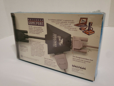

There is also this device Notebook GAMEPORT that connects to a COM port. Guess it's limited to real mode games as it requires a driver to work. This one is also not easy to find, though.
