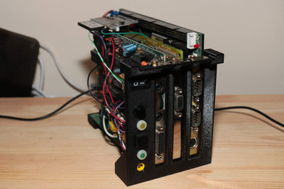

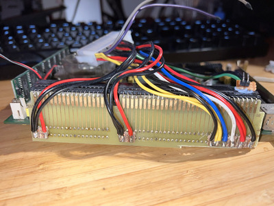

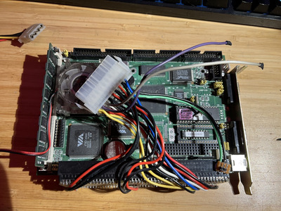

Reply 4 of 6, by Thermalwrong
I've done this and it works, this particular SBC has super I/O and video integrated so the extra port is for the sound card.
I got an ISA single port angler, soldered another ISA connector onto the edge connector - along with the ATX connector from one of those 24pin to 20 pin ATX connectors that I sacrificed.

There's a little header for the on/off switch and the power wires were soldered onto bits of stripboard to add some strength.

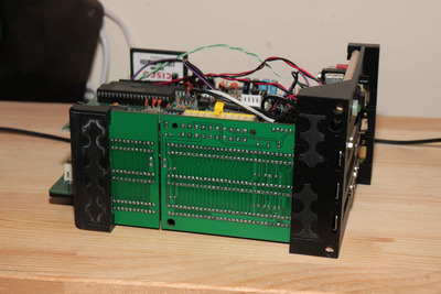

I considered doing this to a 3 port ISA riser but didn't in the end because I don't like the idea of soldering onto the hard gold pins of the ISA header. Later I designed up a PCB to be a 3 port riser which simplifies the wiring significantly for SBCs:

Reply 5 of 6, by megatron-uk
Yeah - that 'shoebox' formfactor is exactly the sort of thing I am looking to achieve. Great stuff!
Did you 3d print the IO bracket holder or did you find a supplier?
https://www.target-earth.net
Reply 6 of 6, by Thermalwrong
It's all 3d printed with some wooden dowels to give some strength to it, since I had those laying around at the time. I didn't share the designs because the PCB design has a couple of flaws, specifically in that it didn't need to be 2 boards and the ATX connector is too close to the cards.
