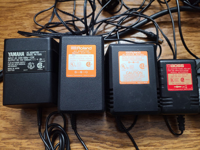

Just to give some examples of my experience, here are the ones I have on hand that I have used in the past. At this moment, none of these have been used to run anything in the past year or two except the ACI-120J (which my DMM is saying is only putting out 1V when not loaded... which is obviously not an accurate reading if it works).

The Yamaha PA-1505 came with my TG100 and obviously isn't compatible with the others. The Roland ACK-120 came with an MT-200, the ACI-120J with an SC-55, and the Boss PSA-120T was given to me with an SC-7. Not sure if any are "original" to the devices received them with, but they've never given me any problems. Still, they haven't been used in a while.

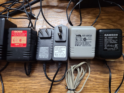

The Ablegrid and generic 9v 1A adapters have both run several of my modules with no problems at all... but their size certainly makes it feel sketchy to use them in place of the massive ACK-120.
The CyberAcoustics is one that I've kept around from a junky old set of speakers that went bad after running them too long on a 12v power supply (moar powah 🤣), simply because it is 9v with a center negative plug. Haven't tried running anything with it, but it feels pretty heavy and solid compared to the modern generic ones. The Samson came with my Orla MicroPartner module and worked fine with that when last used.
