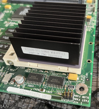

I used 3M thermal adhesive tape to attach the heatsink to my P60, works great. Looks like it was originally stuck on with some sort of thermal epoxy as some traces and marks remain on the CPU, but when I got it they were already separated.
Also, the Socket 4 on my Batman's Revenge board has no tabs at all (and it's not that it had tabs that were broken, it just doesn't have any), so gluing the heatsink to the CPU seems like the only option in my case. There are a couple of holes near the socket which I suspect may have been used for a custom fan/cooler assembly, but not sure about that.
533.61 KiB
105 views
P60 with heatsink
Measurements are as follows: base 55x50mm, height 21mm
You can use a much smaller heatsink because you always want to have a fan blowing air on it. Even a large heatsink like mine gets really hot really fast without any active cooling. I think most cases back then had the bare heatsink with some fan nearby providing some airflow, but nowadays a fan on top of it seems like the simpler solution.
