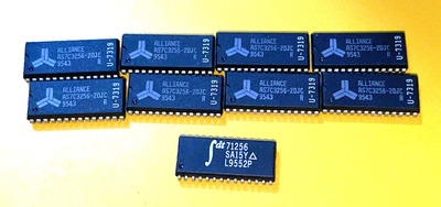

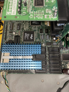

The only problem is that the computer is not near me 😀 … until now. here the pics

Are those 20ns cache chips? They won't run much past 50MHz FSB, I guess?
Reply 13 of 18, by AlessandroB
H3nrik V! wrote on 2023-01-31, 08:43:
AlessandroB wrote on 2023-01-31, 07:20:
CoffeeOne wrote on 2023-01-30, 20:40:
Sorry to ask, but ....
What is the problem in uploading pictures at Vogons? Works like a charm.
Do not use external hosting sites, please. It is annoying, there are tons of old posts, where the pictures are missing.
I tried running the computer with a 233MMX and it works fine, bus 66, so I think the chips are working fine.
another question I wanted to ask you, in the photo you see a series of connectors on the left edge and if you read on the serigraphy you see the word "Turbo". I tried to close it with a jumper but I didn't see any effects… what do you think?
Reply 14 of 18, by Gmlb256
I do have a Gigabyte Socket 7 motherboard that has the Turbo pins which is for a toggle button that sets the FSB to 50 MHz, it is more effective when disabling the L1 cache. Yours is only for the Turbo LED according to the manual.
