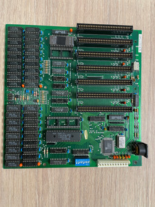

Hello!
I need help identifying an XT motherboard.
Also to identify the function of the J5 pins.
Thank you!

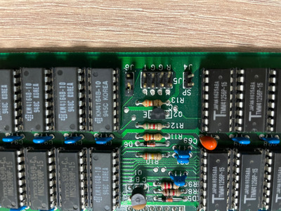

Reply 1 of 7, by Horun
To me with just guessing. The G are ground. The R is reset, the K is KB lock, the T is Turbo sw and the L is Power LED. SP is speaker...
So reset is R to G, Power Led is L to G, etc.
What are the letters hidden by jumper on J6 ?
Reply 2 of 7, by lizageza
Horun wrote on 2023-02-25, 23:48:
Thanks for the tips.
Above the J6 there is probably a "TL". (From the first picture, because I'll have access to the board again on Tuesday.)
Reply 3 of 7, by Horun
lizageza wrote on 2023-02-26, 00:49:
Ok if it TL that could be Turbo LED and should not be jumped until we figure out exact what it is....or it could be for a Turbo switch...and the other TL Turbo LED...
added: The AMD 8088-1 can run at 10Mhz so the board would be considered a Turbo XT. With 30Mhz Xtal it seems on par with some other Turbo XT's...
Reply 4 of 7, by rasz_pl
This is very late XT clone. 88 date codes on few TTLs and ROM, 89 date code on crystal.
>ACER 710 MT86G011 Chip - Cross reference using a
MT86GOll chip. The following functions are incorporated
within the chip:
• 82C88 Clock Generator
• 82C37 DMA Controller - channel 0 is used for refresh.
• 82C59 Interrupt Controller - 8 channels
• 82C53 Timer
• 82C55 Peripheral I/O
• Parity Check Circuit
• Wait-state Logic
• ROM Decoder - 2764/27256 or 27256/27256
• RAM Decoder - 256K or 1 Mb DRAMs
• EMS Extension Memory Bank function
• HfW and SjW CPU Speed Change function
• 4.77l\1Hz DMA Clock
Reply 6 of 7, by rasz_pl
doesnt DTK MBX-1101 have a chip labeled "ACER M1101"? https://minuszerodegrees.net/xt_clone_bios/xt_clone_bios.htm SUPER%2010-B1.jpg
It does look like the same thing on the first glance.
There is also this: https://forum.vcfed.org/index.php?threads/tur … -turbo.1218365/
mcyi5vj-jpg.1218366
also Volleman MB-088 https://forum.vcfed.org/index.php?threads/rev … rboard.1213602/
and maybe Pravetz 16? https://bazar.bg/obiava-39532964/pravets-16-dano-i-5-platki
nope, pravets 16 is just a clone board based on some NEC chip
Reply 7 of 7, by pshipkov
There are 2-3 designs that everybody copied from for their branded Turbo XT assemblies.
Also, there are 2-3 highly integrated chipsets that everybody relabeled "as they see".
So, many motherboards look very similar.
DTK BMX-1101
Pravets 16 is a cloning, a 1:1 carbon copy really, of Juko XT.
That board is different than Acer M1101 based designs.
