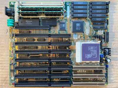

I recently added an ABIT AB-AH4 socket 3 VLB mainboard to my collection.
https://theretroweb.com/motherboards/s/abit-ab-ah4

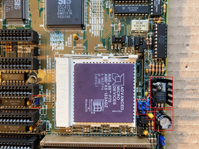

Initial tests with a DX2/66 CPU were quite disappointing so I decided to do try some upgrades.
Because all the components needed for using 3.3V CPUs are present but unpopulated on this model, I converted it into an ABIT AB-AH4T by adding the necessary components:
- 4 x 3-pin jumper
- regulating transistor plus heatsink
- 2 x resistors as voltage divider for 3.3V output voltage
- one electrolytic capacitor for output filtering 1000µ 10V
- a tantalum capacitor 10 - 22 µF for ripple reduction at the "ADJ" input
Note that the AB-AH4/T does not have landings for the additional resistors that you need to select 3.45V, 3.6 and 4.0V, because ABIT had a fixed regulator for 3.3V in the "T-model". They just prvided the landings for one resistor between the "ADJ"-pin and ground to turn the regulator off completely when 5V CPUS were jumpered.

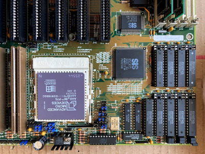

Here´s a total of the finished mainboard
1.21 MiB
864 views
and here I marked all the components that had to be added
1.14 MiB
867 views

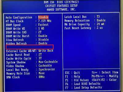

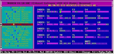

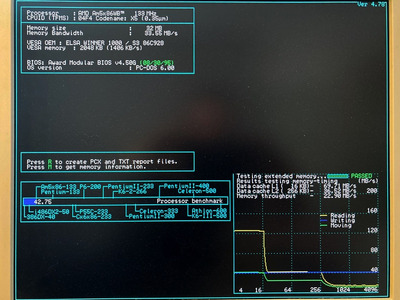

I then flashed the latest AWARD BIOS and did some testing with a AMD-X5-133ADZ. Everything looked a lot better now, but I found out that write-back isn´t / cannot be enabled for the CPU´s L1 cache.
The chipset definitely does support write-back so I suspected the BIOS to be the issue here.
After editing it with Modbin and enabling all the disabled entries under "chipset features" and rearranging the entries so all of them fit into the left and right table I found the entry "Internal Cache WB/WT" wouldn´t show up in the menue in the left table, a blank line is presented instead (you can also see this in the Modbin preview). Moving it to the right table didn´t help either.
177.38 KiB
867 views

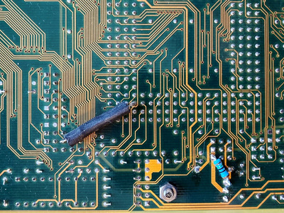

So I tried a hardware mod as a workaround next. The CPU-pin for enabling/disabling WB could be found easily and on the AB-AH4 it´s even routed to a pin (3) of Jumper 15.
According to the AMD x586 datasheet this pin needs to be pulled up during reset to enable WB. I pulled it up with a resistor but either - when the resistor is >47K, WB is not enabled, or, when the reststor is about 10K (or less) the system crashes with a garbled screen at DOS-prompt.
When the pull-up resistor is present during POST and removed immediately after, then WB gets enabled correctly and the system works perfectly.
So I hooked the CPU´s WB-Enable input pin to the SIS 85C471´s "RESET_DRV" output with a 4K7 resistor that provides a pull-up at startup for a short period only and the issue was solved.

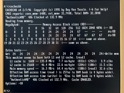

The result´s don´t look bad:
229.8 KiB
850 views
270.81 KiB
839 views

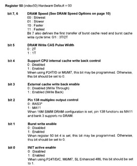

I also tried to edit the chipset register ("50", bit 4 and 3), but one of the bit´s cannot be edited as it seems.
71.51 KiB
849 views
Maybe someone here can throw it into modbin and have a guess what´s to be done...
Reply 2 of 54, by mkarcher
majestyk wrote on 2023-02-27, 09:55:
That's not a bug, that's a feature: This setup option is ignored unless you install a Cyrix processor. While the cache mode on AMD and Intel processors is hardware controlled, the cache mode on Cyrix processors is BIOS controlled. Unlike many other BIOSes that always show this option, your BIOS is smart enough to hide the option in cases where it wouldn't have an effect anyway.

After checking all jumpers and connections that are involved in L1 WB mode and finding absolutely no errors I found out that pulling WB/WT up with 10K or less is necessary to enable WB at reset (values higher than 20K don´t enable WB safely).
Then I was confronted with the same garbled screen at DOS-prompt as in the very beginning.
Out of a hunch I started testing different BIOSes for this chipset. All of them either crashed or in the best case had the same results.

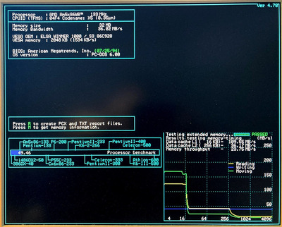

All of them were AWARD ones so I finally tried the latest AMI BIOS from 1994 and all problems were solved:
https://theretroweb.com/motherboard/bios/ah4. … 89873319274.zip
I can enable AND disable both L1 and L2 and I can enable WB for L1 like it should be.
In Speedsys CPU score went from 42.75 to 49.46, the memory performance scores went from 69.71/36.52/ 22.90 to 109.55/36.17/23.75

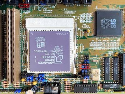

All the necessary jumpering IS provided on this mainboard (but you have to add lots of jumper-pins). Only pulling up "B13" at the CPU needs to be done with an additional resistor.
Here´s the working jumpering for this setup, added jumpers have blue colour.
1.05 MiB
670 views
Note that this is one of the mainboards where you have to put a jumper on the "Turbo Switch" header (pins 2-3) to have full speed, otherwise you´re in permanent "Turbo" non-speed.

Reply 10 of 54, by majestyk
The BIOS code disables the WT/WB option and masks it in the chipset setup table as soon as there´s not a Cyrix CPU detected (I haven´t tried DX4-WB ones so far), overriding other BIOS mods / settings. (In the AWARD BIOSes 5 of the 8 bits of register 50 are "X-ed").
70.22 KiB
612 views

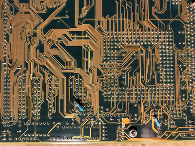

On the mainboard´s flipside theres was not much to do, just adding two resistors, no need to cut any traces:
977.68 KiB
622 views

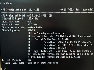

Reply 11 of 54, by Chkcpu
Hi majestyk,
In addition to mkarcher’s excellent information, I like to contribute some info about the BIOS on this AB-AH4 board.
I’ve looked into your Award 08/30/95-SIS-85C471E/G-2C4I9A12-02 BIOS and found precisely what mkarcher writes: this BIOS has no support for the Am5x86-133 and won’t set the WB protocol enable bit in the chipset.
If you had set the Am5x86 multiplier to x3 mode it would have worked though. The BIOS will recognize the Am5x86 as an Enhanced Am486DX4 then, a CPU it supports including L1 WB.
But of course this is not why you installed an Am5x86-133. 😉

Reply 16 of 54, by majestyk
Chkcpu wrote on 2023-03-02, 10:52:
...Hopefully setting these 2 jumpers to the P24D/P24T position will fix the issue.
Jan
Yes it will!
One of the DACKs was set to "pull down" (jumper 21).
After correcting that, the system would hang at POST summary screen like it did before when chipset "PCD" was connected to CPU "PCD". After jumpering chipset "PCD" to connect to CPU "CACHE" (as I always thought it should be) all is well. Memory benchmarks have improved even further: 117.62/50.99/31.10
The new jumpering:
580.42 KiB
516 views
I will now program the EPROM with your AWARD version.

Reply 17 of 54, by Chkcpu
Okay, this is great news! 😀
Yes, it makes sense indeed, to connect CPU “CACHE*” to Chipset “PCD” because this chipset pin 118 changes function to “CACHE*” when both DACKs are pulled high.
I use the same jumper settings when running an Am5x86 in L1 WB mode on my SiS471 board;
- CPU “CACHE*” to Chipset “CACHE*” (PCD)
- CPU “HITM*” to Chipset “HITM*”
- CPU “WB/WT*” pulled high
- but I have CPU “INV” unconnected.
It works fine that way, but it may not be set for optimum performance. I need to experiment more on how to connect the INV signal and if connecting it to W/R* works better.

I have a QDI board with the same chipset and with 5x86 running at 3x50MHz. So this thread is very interesting to me.
Question about the speedsys' graph - shouldn't we see the blue line (write speed) also represent difference between L1 and L2 cache "space" when write-back is enabled?
Reply 19 of 54, by majestyk
Chkcpu wrote on 2023-03-02, 19:17:
...One remark about the AH4_J1 BIOS, the Am5x86 support in this 11/28/95 SiS471 BIOS is great, but this BIOS doesn’t support the […]
...One remark about the AH4_J1 BIOS, the Am5x86 support in this 11/28/95 SiS471 BIOS is great, but this BIOS doesn’t support the Secondary IDE port. So only a Primary Master and a Primary Slave drive are supported.
Under Win9x this is no problem, but if you need 4 IDE drive support in DOS, I could try to patch the original AB-AH4 08/30/95 BIOS because it supports both Primary and Secondary IDE ports.
This would involve adding Am5x86 support including the x4 multiplier and fixing the 2GB HDD display limit bug, so this may take some time… 😉
Jan
Personally I´m o.k. with one IDE channel, but when someone would use a VLB-IDE controller that doesn´t bring it´s own BIOS this could be a limitation. (An ISA SCSI-controller would probably have inferior performance.) So if you have some spare time one day, it might be worth giving it a try.
GigAHerZ wrote on 2023-03-02, 20:39:
Wow - are you running 50 MHz FSB with a VLB video card? If so, which one is it?
Isn´t the higher throughput for memory writes rather a matter of "Write Policy" / Write Allocation" than "Write Policy" /Write Back? Early Intel and AMD CPUS lacked some of the features.
