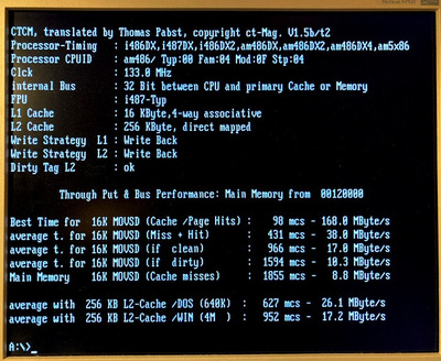

Here´s the report for my FIC 486-PVT-IO
177.93 KiB
1046 views
It reported "Dirty TAG L2: N/A" before I enabled "Combine Alter & TAG Bits" in BIOS.

Thanks for attaching that version, although the screenshot clearly shows it's version 1.5b, not version 1.0. Nevertheless, it's a good version to run on a 486 system, and your screenshot is a good reference for the output of ctcm on a properly configured Am5x86 L1WB/L2WB system. "Dirty TAG L2: N/A" would indicate L2WB in "always dirty" mode, which is slower than L2 write-through in many use cases.

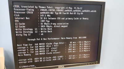

EDIT2: I think i got everything working now. The L1 cache speed jumped from ~89MB/s to ~129MB/s. Love it.
NB! The CTCM 1.6 and 1.7 claim that i have 2048kB of L2 cache and both L1 and L2 work in write-through mode. CTCM 1.5 doesn't recognize L2 cache at all, but at least claims that L1 is working in write-back mode.
Am i correct that L1 WB can be "detected" by seeing higher "copy" speed in speedsys than the "read" speed is? Is it always the case or am i "special"?
Yes, that's a very good indicator of proper working L1WB cache. While the write test of speedsys misses L1/L2 all the time, the move test moves likely from one address to the same address, so it writes to those addresses that were just loaded for reading, so you get write hits all the time. If all writes are hits, and the whole amount of test memory fits L1, so nothing needs to be written back to L2 or main memory, you get the most of L1WB.

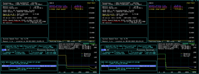

Reply 34 of 54, by majestyk

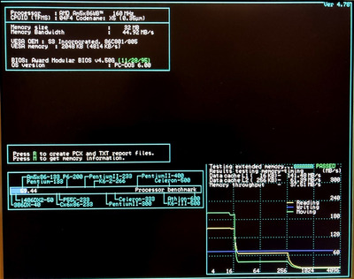

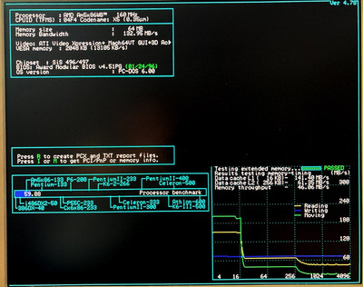

I just compared the speedsys benchmarks of the ABIT AB-AH4T with those of my Chaintech 486SPM (M102B) also running @ 160MHz at the fastest memory settings. The 486SPM has the follow up SIS chipset 85C496 / 497 with PCI support (and onboard super I/O) I also added PS2 mouse support.
1.07 MiB
940 views
208.4 KiB
945 views
I was surprised there´s virtually no significant difference between the two chipsets as far as memory performance is concerned.
Reply 35 of 54, by CoffeeOne
GigAHerZ wrote on 2023-03-04, 19:25:
I've tried this, 1.5, 1.6 and 1.7 and it seems to show complete BS when you have 1024kB of L2 cache. 1.5 says there is no L2 cac […]
mkarcher wrote on 2023-03-04, 18:14:
GigAHerZ wrote on 2023-03-04, 12:55:
Any good tool that would reliably test if the L1 (and why not also L2) cache actually works properly in write-back mode? Any good experience with some tool?
You could use Heise's "ctcm" utitility (c't Cache Measurement), made by the german IT magazine "c't". An official download link is ftp://ftp.heise.de/pub/ct/ctsi/ctcm17a.zip , on a 486 computer that version should be invoked with "/NOP" to prevent a crash. In most cases, this utility can correctly identify the cache mode, and whether a write-back L2 cache runs in "always dirty" mode or in a proper configuration.
1.5 says there is no L2 cache.
1.6 and 1.7 say that there's 2048kB of cache and everything is in write-through mode. (Thanks for the /nop hint!)
But i've modified the bios ( QDI V4S471/G locks up with 1024kB of cache [Fixed! Nicer Award BIOS available!] ) and i'm absolutely sure that at least L2 cache is in write-back mode.
EDIT:
But thanks to this thread, i started tracing the tracks on the motherboard and this is the information about my QDI board. ( https://theretroweb.com/motherboards/s/qdi-v4s471-g )
JP44: Multiplier. 1-2=4x, 2-3=3x
JP18: DACK1. 1-2=Pull-down, 2-3=Pull-up
JP19: DACK0. 1-2=Pull-down, 2-3=Pull-up
J14: pull-down CPU B13 "WB/WT"
J11: pull-up CPU B13 "WB/WT"
J12-1: CPU B12 "Cache"
JP29-2: CPU A12 "HITM"
JP28-1 = pull-up
JP28-2 = CPU A10 "INV"
JP28-3 = CHIPSET 104 "W/R"
JP8-2: CHIPSET 118 "PCD"
This thread has a lot of good information. Thank you! I'm tracing that information all back to my board and hopefully i'm going to have a blazing fast 1MB L2 cache equipped 486. 😀
Hi,
When ctcm cannot detect the amount of l2 cache automatically, you can specify it.
for example
ctcm /l2=1024
Reply 36 of 54, by CoffeeOne
majestyk wrote on 2023-03-10, 08:56:
I just compared the speedsys benchmarks of the ABIT AB-AH4T with those of my Chaintech 486SPM (M102B) also running @ 160MHz at t […]
Are you sure, that you have fastest memory timings? cache through put is good (2-1-1-1 and 2 obviously), but......
I have ~10MB/s more on the Asus SV2GX4:

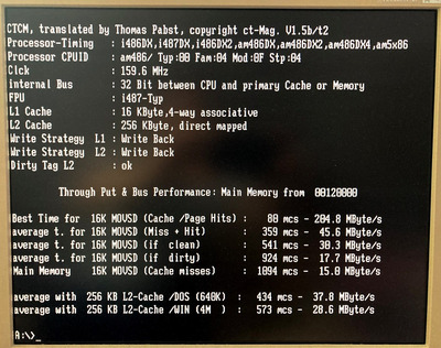

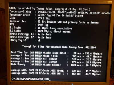

I think for 486 it is better to use ctcm1.5
But I confirm that 1MB L2 cache is not detected properly.
as already mentioned ctcm /l2=1024 does the trick.
Values seem to be OK, for me L1 WB and L2 WB with working dirty is shown correctly
1.78 MiB
903 views
Reply 38 of 54, by GigAHerZ
Thank you! CTCM 1.5 with pre-defined L2 cache size works and confirms that my 486 is in top-notch configuration. (Y)

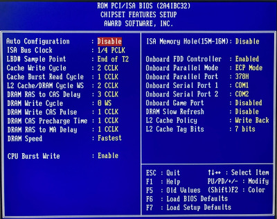

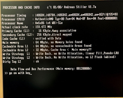

Reply 39 of 54, by majestyk

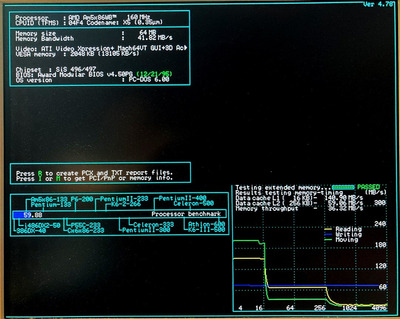

Setting "Cache TAG Bits" from 8 (default) to 7 makes the difference in memory throughput performance in my case. When I set it to 7 the speedsys benchmarks are very similar to thoseCoffee One has:
335.5 KiB
884 views
245.08 KiB
884 views
I´m not sure what the reason is here, do you need 8-bit for larger RAM sizes? I only tested 64M (4 x 16M).
These are my current chipset settings:
239.85 KiB
883 views
I also tried "DRAM RAS to CAS Delay" set to "2" but then the system hangs after memory count.
EDIT:
It´s always a good idea to have a look at the output of CTCM 1.7 also:
248.24 KiB
874 views
The cacheable area is limited to 32MB under the 7 bit cache tag setting. "Coffee One" has the higher memory throughput with 64M RAM - because he has populated 1M L2 cache! Probably you need 512K for 64M (and 1M for 128M RAM).
So if you run a mainboard with this chipset with 256K L2 cache make sure you use 32M RAM or less and find a way to set TAG bits to 7 - or upgrade L2 cache 😀
