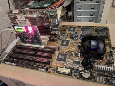

I got this board a few months ago and it's honestly driving me crazy.
I wanted to build a nice Windows 95 machine with this and put an overkill graphics card into it.
There are three PCI cards at my disposal and only the worst one of them all even POSTs.
- ATI Rage 128 - black screen, board hangs
- ATI Radeon 9250SE - black screen, board hangs
- Matrox Mystique 220 - boots fine
Since this is a really early Socket 7 board with AT power connectors and 5V PCI only, I immediately thought about the great adapter project from here and converted one of the PCI slots to 3.3V. Still, no dice, even though I did the mod properly and have 3.3V everywhere it should be.
Since I don't really like giving up on old and obsolete hardware I then got a postcode analyzer card.
The board at least tries to boot, which is nice - but with both ATI cards, it stops at 0dbf:

Almost at my wits' end I tried one last thing: Update the BIOS. I noticed that my board had such an early BIOS version, it wasn't even on the web anywhere.
So I submitted that to theretroweb (at least something I was able to contribute) and updated my board to the latest BIOS 0312.1.
Apart from the board now properly detecting my K5 90MHz correctly, it still didn't change anything. I'm out of ideas.
Do I really have to give up here? Is the SIS chipset really such a piece of absolute garbage that it can't even drive a Rage 128? 😒
(I also hate that it can't even boot from an IDE CDROM drive, but let's not get started on that...)

Now one more thing I could say, since it looks like an award bios in your picture, is when I reversed engineered a v4.51, the bf post code seemed to be the stage where pci configuration happens. This is my limited experience opinion.
But it wouldn't hurt to try some older pci cards, or even isa just to get a better feel. Those are a bit later pci cards for an early pentium board. I suppose the mystique is the oldest, and that is the one that does work, doesn't it?

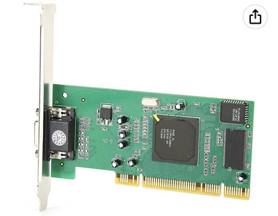

This right here is my own personal go to card for these 586 systems. (This exact pcb)
I have found th much cheaper though. 40$ usually
Note, haven’t tried on sis though. Usually intel/ali/via
Why? It's a nice enough card and offers DVI, which is a boon on new monitors - but it's over five years younger than this board. If it supports 5V PCI it *should* work, but if not, it's like judging a pensioner for his ability to run a marathon. Some can, but it's hardly a fair criterion, and the added value of the GPU is completely lost on a system this old. If I really wanted DVI I'd rather look for an nVidia card for their better VESA support than ATi, and if I didn't care about VESA but wanted DVI, I'd go with a Matrox G450 PCI as they are much cheaper and easier to find.
My go-to for boards from this era is decent-quality S3-based cards from Diamond, Elsa or Miro, although I tend to test with an ISA card with Trident chip - they will work on anything (including 8b 4.77MHz ISA) and if something goes horribly wrong, it's not a huge loss.

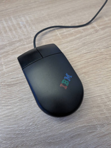

I've now received an old ball mouse that works fine on all my computers with PS/2 ports.
On this Asus board, the machine still hangs when I move it around.
I guess I need to give up at this point. Something on this board must be broken, maybe it's the AMIKEY chip or something else.

At least I got a nice old IBM mouse and a few PCI graphics cards out of this whole endeavour! 👌

You could try a rage xl in that 3.3v slot 😀 they are on amazon brand new.
This is very much the case.
My PC Chips M571 will not post with my Diamond Rage 9250se PCI or even my crappy Diamond Fire GL (Permedia2) PCI.
It is happy however to boot with either of my equally crappy ATI Rage XL PCI cards.
All of these cards work just fine in my Tekram and Soyo SS7 boards.
