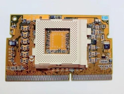

Reply 1 of 15, by Grem Five
PCChips / ECS Madex PII CPU Card ver 1.5
PPGA Celeron / 66 / auto voltage
PCChips / ECS Madex PII CPU Card ver 1.31
PPGA Celeron / 66 / auto voltage / no voltage clamp
Odd enough the 2nd one pic the name you have listed and picture dont match. The picture you put up appears to look like : AA370P 370CPU rev 1.0 FCPGA Coppermine / 133 / auto voltage / no voltage clamp
Reply 2 of 15, by AngryByDefault
Grem Five wrote on 2023-05-14, 23:48:
PCChips / ECS Madex PII CPU Card ver 1.5 PPGA Celeron / 66 / auto voltage […]

The 3rd depicted slotket is Coppermine compatible for sure. I have at least one such slotket in my drawer. I have about 15 slotkets in total.
If you have soldering skills you could modify a PPGA slotket, otherwise stay away from them.

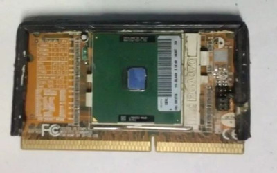

Reply 7 of 15, by Grem Five
The 3rd one you added looks like Super Slocket-III / CPU card ver 1.0 FCPGA Coppermine / 133 / auto voltage / no voltage clamp

The "370cpu" definitely is Coppermine compatibel. I have one in my P3B-f at 980MHz (fsb 140).
The board should support it as well, as the slotket is dumb a.f.

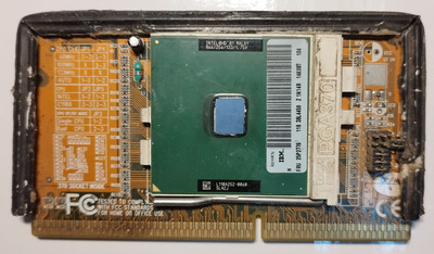

Thank you all for the feedback, I bought it and it arrived a few days ago.
It looks nasty 🤣 ... I haven't got the time or nerve to test it yet.
I knew this would be a "fun" project from the moment I got that mainboard...
The attachment IMG_20230528_190157.jpg is no longer available
The attachment IMG_20230528_190232.jpg is no longer available
The attachment IMG_20230528_190720.jpg is no longer available

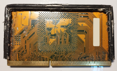

The seller mumbled something about it not working on a Pentium II, and added a P1 200 MMX in the box... Out of guilt I guess? God knows what and how he attempted to test.
The pictured P 3 was included in the sale and it's an 866 MHz 133 FSB unit. Not bad *if* it works.
Not compatible with my board but I have a 700/100 P3 and a 900 Celeron around (not sure of it's FSB) so that should get me started.
When the time comes I will most likely need some help to setup it up correctly.
Reply 10 of 15, by AlexZ
I see a few badly scratched traces near the middle on the back side, therefore I doubt it will work.

Reply 11 of 15, by PcBytes
AlexZ wrote on 2023-06-07, 10:39:
If you mean around the middle of the socket backside, that's actually tape residue.
Either that or hot glue, as someone (either seller or someone else before @AngryByDefault) dumped a kilo worth of hot glue.

Reply 13 of 15, by AlexZ
PcBytes wrote on 2023-06-07, 14:51:
I see two severed traces and one damaged to the left of that hot glue spot.

Reply 14 of 15, by AngryByDefault
Hi all!
Yeah... it doesn't look good ... I will probably try to fix it, if it comes to that.

Reply 15 of 15, by PcBytes
AlexZ wrote on 2023-06-07, 20:25:
You're right, I didn't notice them. Nothing unfixable though, and it may only be the lacquer that's gone at that - a multimeter shall tell.
