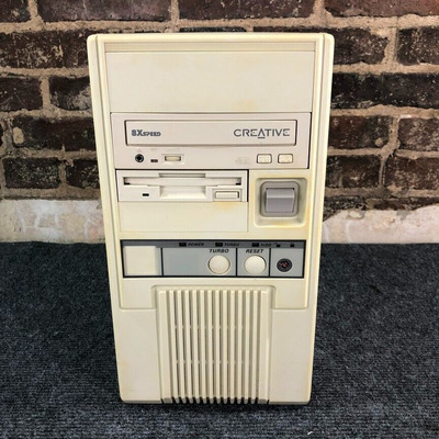

I recently picked up one of those coveted Taiwanese AT clone cases we all had back in the late 80's and early 90's but it's missing the CPU clock LED that usually mounts next to the turbo button.
I can't seem to find a part for that so I was looking to build one from some kind of generic two-digit LED and wire it up similar to this guy's thread - CPU Clock Speed Diplay
Any help or tips would be greatly appreciated! I'd love to complete this look and I've been searching for a case like this for a long time and this is the first one semi-affordable I was able to get hold of.

Reply 1 of 5, by wiretap
You can find them on ebay sometimes. I purchased a few from there.
Alternatively, feel free to modify/build one of these: https://github.com/wiretap-retro/2-digit-Turbo-Display
I have a few different variants in my Github repo. ----^

Thank you a million! What search terms do you use for eBay to find em?

I looked at https://github.com/wiretap-retro/2-digit-Turbo-Display and while it is using ridiculously cheap and easy to program ATtiny85 its also complicated because of it, not enough pins means its also using two SN74HC595DR shift registers so cant replicate using off the shelf dev board, need this exact pcb manufactured.
Instead https://microdigisoft.com/2-digit-7-segment-d … h-arduino-nano/ https://www.instructables.com/Arduino-Nano-LED-Display/ Arduino Nano is $2, dual 7-segment display will also be $1-2, you need to measure your hole to get the appropriate size one.

MHz Display, search in the electronics/computers section. They come up every so often. Right now I only see two at a ripoff price.
