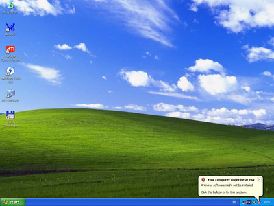

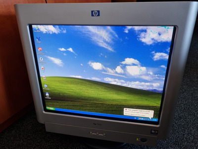

I bought a Radeon 9600XT to power my P4 gaming PC. Everything is working fine, except it showing blue pixels on the screen (I reckon it has problem showing some sort of colors).
I tried different types of monitors CRTs,LEDs and different outputs VGA, DVI and all showing the same blue pixels.
To my surprise, screenshots made by WinXP are perfect.
Could it be the VGA and DVI outputs?

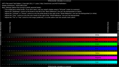

As a photographer, those "blue pixels" and the bright white clouds within are very similar to the typical overexposure "clipping." Could it be your output has been set to 16-235 instead of 0-255? While this setting is usually reserved for HDMI output, your symptom is way too similar to clipping at 235.
Take a look at the attached calibration chart with full-screen; where do blue pixels appear?
104.44 KiB
1507 views
Somehow I have a feeling that red pixels might appear around black areas......

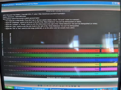

There it is.

That's interesting, so apparently it completely lacks red in that specific color gradient area, so everything that have red mixed in will display color without it. Probably an obscure driver bug.
Reply 6 of 33, by dormcat
kalanneni wrote on 2023-09-11, 06:13:
There it is.
So it's not clipping but missing at or around 219 of the red channel. Never seen this kind of malfunctioning before.

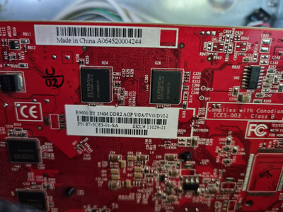

What brand/model is the card and can you share VBIOS dump ?
Reply 16 of 33, by kalanneni
darry wrote on 2023-09-11, 18:55:
If it does the same thing over DVI and VGA, it is not the RAMDAC .
I am guessing that it is either a weird hardware fault OR maybe something to do with a custom VBIOS.
Unfortunately I could only find this label on the card. Trying to gain VBIOS dump information on Thursday.
