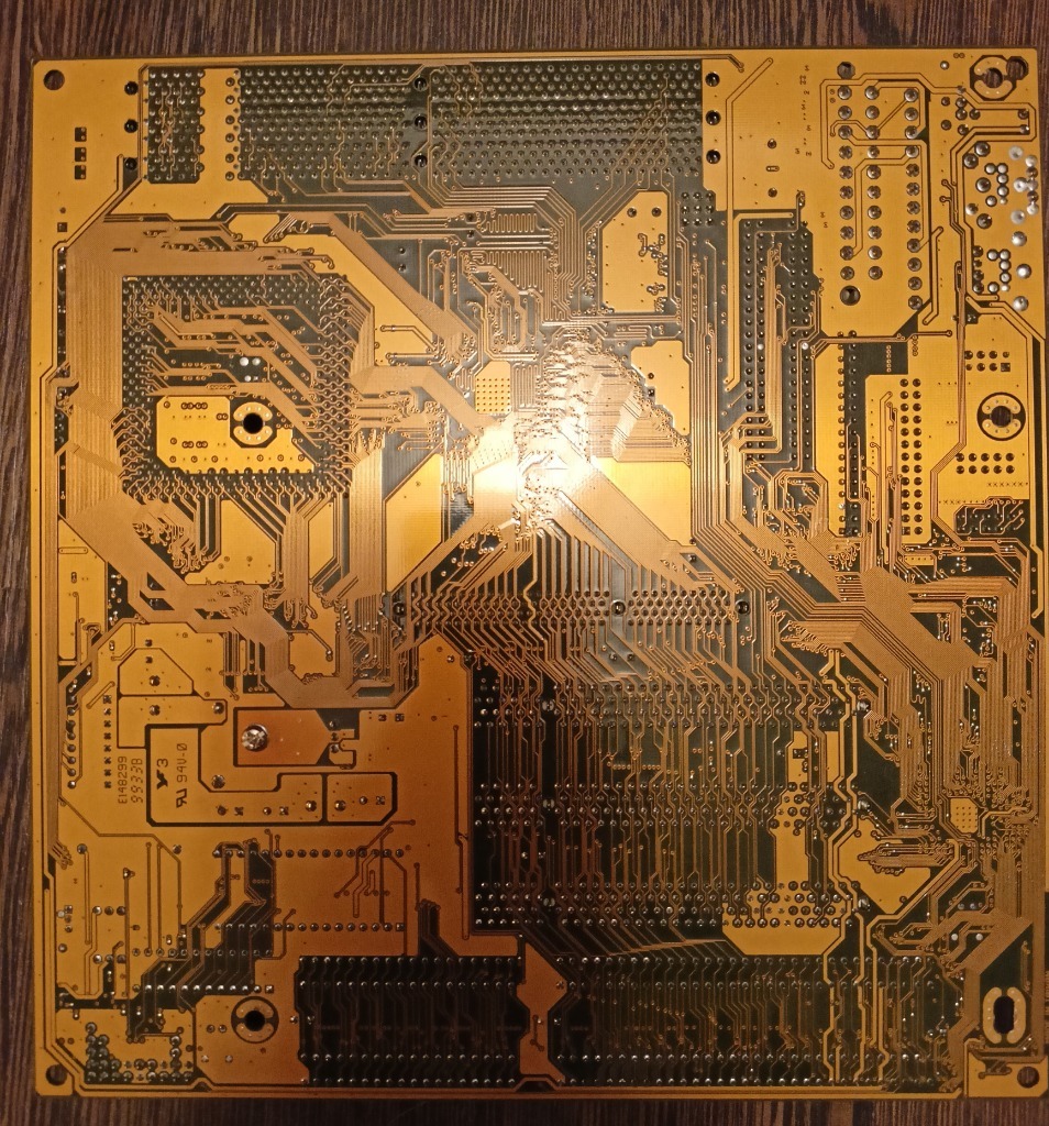

A friend gave me a nice Gigabyte GA-5AA rev 2.2 motherboard with a K6-2/450, which he had stored somewhere for many years. but it does not work. He tells me that it was functional when put away, but it kept restarting, probably due to the problem that I describe below. Hopefully with this board I can build a PC for Win98SE2 and move my PIII to Win2000 (it is the one that currently has w98se2), since I have not been able to get my other socket 7, somewhat older, to work again (nor my 486, I´m having bad luck).

The capacitors around the CPU, about 7, were in bad condition. This is surely the reason for the errors my friend had before on his PC.
At least the clock signals on the buses were in good shape.
I decided to change the capacitors but forgot to do one thing: to measure and photograph each welding point.
When checking the solders, now I have a position of a capacitor that gives me a "short" and that war a hard/bad soldering so I don't know what each point was like before, whether or not it had contact with which veins, and on which side.
These are later images, after desoldering the replacement capacitor to verify.
It seems to me that at the top the circular point does not make contact with the vein, but it does at the bottom (on three sides). Now, I am not sure at all about the square point in either case, it seems to me that it makes contact at the top, but at the bottom I have not been able to clean it well to see how it is (my tools leave a lot to be desired).
I found on picture of the bottom side of this board , but whoever made it had changed all those same capacitors, but left all the burned flux residue and it is impossible to see the points well.
I would appreciate if someone has one and can tell me if this "short" in that capacitor is like that. although I doubt, taking a look at the circuit. It is the TC40 capacitor.
And how are those soldering points, at least in the bottom side, were those are visible.
edit1: I found another image of the bottom side, but with worse resolution. Although I improve it with Topaz Gigapixel AI, it is not enough to be sure what the solder points are like. The round one seems like I said before, but the squared one, na-ah..

Reply 2 of 49, by kinetix
Nexxen wrote on 2023-09-24, 01:48:
Your short, what is the measure in ohms?
If it's diode mode (beeper) it might not be a short.
yes, I was measuring in diode mode
let me see how many ohms....
update: 60 ohms +-10. fluctuates quite a bit, somewhat upwards.
update 2: After cleaning and placing the test leads better, there are 55 ohms almost fixed, with slight variation

Reply 5 of 49, by Nexxen
Since nobody hopped in I'll keep asking for stuff 😀
- a full high res pic of your board, back too
- after soldering new caps, what happened?
- did you insert a new 3V cr2032?
- beeps?
- smoke?
- is the cpu gettng warm, any other component?
Those are electrolytic capcitors, through hole (they go through both sides). It's normal to be separated as one side is usually connected to ground and the other to whatever voltage it serves.
They have a polarity, normally you find a stripe on a side and that indicates the cathode (-). Maybe you know all this, in case disregard.
Holes look good to me, I do worse than that while desoldering.

Reply 8 of 49, by Horun
Question: did you take good top side pictures BEFORE removing the caps so you are sure which lead goes where ? The pics of the top side I found are very poor....
Your square theory does not work. See cut picture attached below from http://hw-museum.cz some are veined, some not... IMHO the design is poor, should have been a bit more room on any via not connected to a plane on the bottom..
This is the cap near the 8 dip switch that feeds off a coil correct?. If the coil is connected then the cap has to be connected to it also if you understand how these VRMs work, one side to coil and one side to ground (there are exceptions but rare)

Reply 9 of 49, by shevalier
kinetix wrote on 2023-09-24, 20:29:
Do they contact the veins?
Horun wrote on 2023-09-25, 02:12:
This is thermal relief, please.... And the design is competent.
A square pad (from normal manufacturers, such as Gigabyte) is a plus, a round pad is ground.
Accordingly, you need to scratch the plain near the round pad and make sure that it is ground, for example, between the scratch and the USB shield or PS/2 shield.
Square should be measured with a coil.

If you measure the resistance of capacitors in circuit and you get a short or low resistance, it can mean that one or more capacitors have developed a high amount of leakage current. This can happen if the capacitors have not been powered on for a long time. You need to desolder all capacitors from that circuit one by one until the problem disappears. Do not turn on the board until it is fixed, it can be very dangerous, I had one such board that started smoking.
Reply 11 of 49, by kinetix

Reply 12 of 49, by kinetix
asdf53 wrote on 2023-09-25, 04:34:
I measure the resistance in that place without the capacitor
Reply 13 of 49, by kinetix
shevalier wrote on 2023-09-25, 03:58:
I think you are correct, it took me a lot to extract the tin and open the hole the first time, it barely melted, I realized the circuit "swallowed" the heat. That's also why it was even more difficult for me the second time.
Reply 14 of 49, by asdf53
kinetix wrote on 2023-09-25, 04:49:
Did you measure with all of the capacitors currently removed? If there are other capacitors in the same circuit, you need to remove them as well.
Reply 15 of 49, by asdf53
From the picture in your first post, it can be seen that the component lead that is next to the capacitor (the inductor coil) is connected to the top and the bottom plane. This means that the square pad of the capacitor must have also had connection to both sides before, so the soldering can not have caused this short circuit.
Reply 16 of 49, by kinetix
asdf53 wrote on 2023-09-25, 05:24:
Yes, it seems more and more to me that the square point is connected to the veins on both sides of the board. At the top it is obvious, at the back it should be like this and the reason why the tin has stuck so much and evenly, if there were spaces it would not be like that. But until I try to clean it better, I won't be sure.
It's homework for tomorrow.

Reply 18 of 49, by asdf53
Do you still have the capacitor that you desoldered? Measure its resistance. If it is low or short, it is leaking. And I can see at least one other capacitor connected to the same circuit. If this one is bad as well, it could be the cause for the short circuit. Desolder it and test the board again.
Reply 19 of 49, by snufkin
Just wondering, but is 55 ohms actually a problem? That's only going to be a few 10s of mA, which might just be leakage currents. It doesn't sound like a metal-metal short. Anyone know what would be an expected value would be on this board? I've got a vague memory of measuring resistances on a working Athlon motherboard and getting low resistance (10s of ohms) on at least one supply rail.
