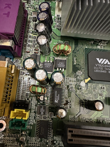

So I’ve had some nostalgia with my PII300MHz mATX build.. But now looking for my next more permanent retro build, I will base it on a Via C3 1.2GHz Nehemiah CPU, in a mid tower ATX case. Chose this CPU due the ability to slow down for the DOS games. But also play Win9x games. Also I couldn’t find a 1.4GHz variant for sale anywhere.
I have the following Slot1/Socket370 boards.
Asus P3V 4X (rev 1.02)
MSI MS-6309 (V2.1)
Jetway J-9ZXAN
Gemlight GMB-P6BIAK V0
Which would be the better one to use? Unsure if the last 2 are capable.
If I need a Slocket I have the following: Abit Slocket!!! AB-FC370 and Gigabyte GA-6R7+
If those don’t would the following work? https://www.ebay.com/itm/144810796158
I will be moving my Labway A151-A00 (YMF719E-S) ISA sound card to this PC. I will be getting a Dreamblaster S2 to use with it.
For Sound Blaster 16 I have a Sound Blaster CT4810 PCI, will that work in DOS also?
Otherwise I have the following also, but will need 2nd ISA slot.
CT4500
CT4520
I will be using a Voodoo2 (PCI) for dos/windows Glide, and either a Geforce2 GTS or Riva TNT2 M64..(both AGP) Should I get something beefier?
Finally the MS-6309 mainboard caps look a bit dodge. Will need a recap I guess..

Both Abit Slocket!!! AB-FC370 and Gigabyte GA-6R7+support the last generation Coppermine cpu's. The SP 370 slotket on Ebay is an earlier model designed for 66mhz Celeron.
Re Motherboard: my vote goes to the Asus P3V 4X (rev 1.02).

Doesn’t Nehemiah require Tualatin compatible slotket or modding those Coppermine slotkets, though?

No, it works with slotket adapters that supports Coppermine CPUs right out of the box.

Great thanks, will use the Asus P3V 4X with Abit Socket!!!, I will update to the latest BIOS. however I did come across these BIOS's Modified BIOSes for ASUS P3B-F, P3V4X, P3V133, CUBX, CUBX-E/L and P3C-E
are these suggested? What is a "crisis recovery procedure". does it mean have a working BIOS chip to replace should anything go wrong, or have an out of socket BIOS re-programmer for recovery?
Reply 7 of 12, by Gmlb256
jabz11 wrote on 2023-10-25, 01:55:
Yes, I'm currently using the latest modded ASUS P2-99 BIOS from him.
That's just in case something goes wrong either during or after the BIOS flashing procedure, but don't worry much about that.
