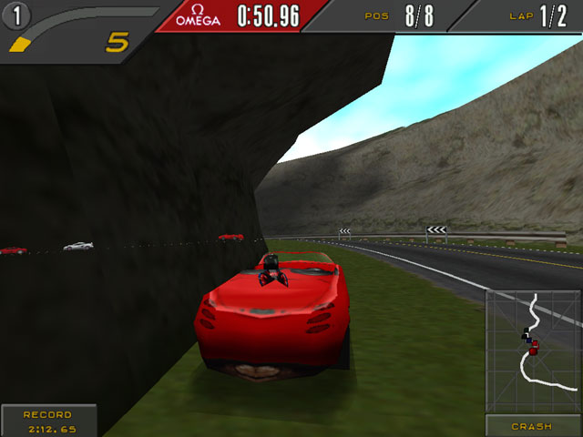

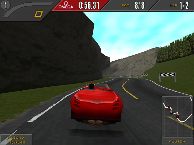

Well I know he's not available, but here's a note for when he does manage to check this thread (I assume even the military have breaks?!?)
Need For Speed II SE - with "enable W-Buffer" on you get drivers in the Ford Mustang Mach III being shown through the car body and you can see road lines and cars through hillsides. With "emulate W-Buffer" on the previous drawing issues go away but you get a flicker on the car shadow and the road lines near the car.

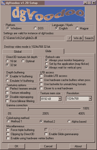

Hi Dege,
The pictures below show the following:
dgvoodoo1.gif = my first page of settings
dgvoodoo2.gif = my second page of settings (Enable W-Buffering ON)
nfs2seWBUFFERon.jpg = with Enable W-Buffering you can see through hills and the driver shows through the car.
nfs2seWBUFFERemu.jpg = with Emulate W-Buffering the shadow under the car flickers and the road lines around the car break up (both white and yellow).
NOTE: both shots were shrunk from 1024x768 to 640x480 to make them fit the forum better.

Reply 77 of 206, by Dege
Hmm... thanks!
It looks like as if scene was drawn without w-buffer. Do you experience this problem in other games too?
Maybe I should release a version which is able to write a log file. It could be more easy to figure out what is going on.
(With w-buff emu, some polygons can be distorted because of the large distance range converted to Z-values between 0.0 and 1.0 .)
