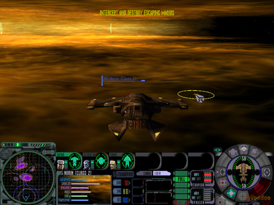

Reply 4 of 8, by yochenhsieh
Since 2.75, in-game graphic renders incorrectly:
Normal gameplay screenshot:
362.55 KiB
1988 views
Dgvoodoo2 2.75 and 2.75.1
228.28 KiB
1988 views
