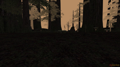

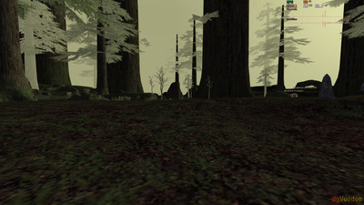

The FFXI fog bug still exists as of v2.75. I check back periodically to see if it was fixed. Shame because other than that it works amazingly well with FFXI.
Screencap of FFXI in Sancuary of Zi'Tah with dgvoodoo2 v2.75 attached. Everything fogs correctly except the landscape. The large tree trunks are apparently part of the landscape while the branches as well as some of the smaller trees are not. FFXI uses some weird methods to render the screen, not surprising as the port was done by a group of programmers who really didn't "do" PC games and had most of their experience with making PS2 games. It seems like they use a common code base for both versions (though the PS2 version was discontinued a few years ago) with some wrapper code to get it working on the PC. Both versions had to be concurrent because both versions used the same game servers and had to be updated with new content at the same time.

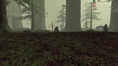

I couldn't find the exact spot, but this is how it should look like without dgVoodoo on with fog working.
I'm now using 2.78 and fog still doesn't work.

EDIT: Please forgive my ignore. The problem wasn't dgVoodoo. It was because the game's ClippingPlane was set too high and bump mapping was ON, that's why the fog dissapeared.
BTW, thank you very very much for developing dgVoodoo. You gave a new life to this old game!

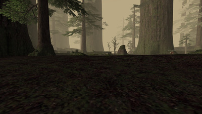

Hi Dege, I've been following this issue on and off for quite some time checking back occasionally to see if there's been any improvement.
I saw the recent build which fixed vertex fog in PSOBB in 2.79.3 and though it might resolve the fog in FFXI as well, however it is still incorrect.
It's interesting to see that some objects in the scene appear like they are "fogged" properly, while others are completely not at all.

The fog bug actually appears anywhere there is fog, it's just that foggy weather isn't common in most outside zones (subtle distance fogging is common inside dungeon zones though). Sanctuary of Zi'tah however is *always* foggy 24/7.
FYI the tops of the giant redwood trees are intentionally missing (you can't see it in these screenshots). Normally they are lost in the fog so you don't see them, so they didn't include the geometry for the top half of the giant trees.
Maestrobob wrote on 2022-12-06, 07:18:
In FFXI geometry is either part of the landscape or it is an object. Landscape doesn't fog correctly and objects do.
