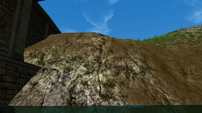

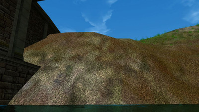

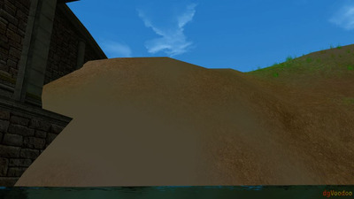

Regression bug in dgVoodoo 2.76 in Dark Age of Camelot (DAoC). Very old game (2001) but still active today. Supports free to play and can be downloaded here: https://trial.darkageofcamelot.com/
Some ground textures/rendering look blurry with dgVoodoo when "Atlantis Terrain" option is enabled in game. Maybe blurry is the wrong word. It looks like a fog effect rendered on top of the base ground texture.
I tested several versions of dgVoodoo to see where the regression occurred...
2.79.3 - bad
2.76.1 - bad
2.76 - bad (regression happened here?)
2.75.1 - good
2.74.1 - good
2.72 - good
2.75.1 and older look fine.
My setup: Windows 10 (x64), NVIDIA GeForce GTX 960 (4 GB), driver version 517.48 (latest), game is 32-bit and uses DX9, bug is in dgVoodoo D3D9.dll.
dgVoodoo settings can't seem to fix the bug (I've tried everything I can think of). I'm typically using default settings + Direct3D 12 (feature level 12.0), 4096 MB VRAM, force trilinear filtering, 4x MSAA, because those settings are a nice balance of performance and quality on my machine.
Atlantis Terrain OFF (looks fine with or without dgVoodoo, but I don't usually play the game configured like this)

Atlantis Terrain ON (this is how it's supposed to look)

Atlantis Terrain ON with dgVoodoo 2.76 or newer (this shows the bug)
