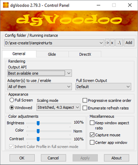

I'm looking for an answer on how to forced windowed mode an old japanese PC game in Win 10.

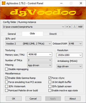

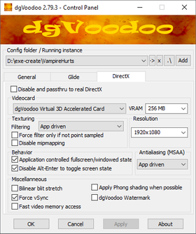

I'm on Win 10 and using DgVooDoo 2.79.3v, provided by a friend who is working on making Megami Ibunrokou Persona old PC port to work on his Win 10. (It worked)

Might be off-topic, but just in case you don't know, the best software for windowing games is DxWnd:
https://sourceforge.net/projects/dxwnd/
There's some way to integrate it with dgVoodoo too, though I personally haven't had much success with that.

Usually it works by just putting the dgv2 files in game folder and just hook with dxwnd. It doesn't work always and sometimes you can enable Main/Force Windowing in DxWnd to force a windowed mode.
