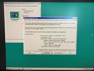

Recently I've put together a retro pc and the only game I'm unable to run is NFS Porsche. Such a great game!
I have a win98SE / Semprom 2600+ 1600MHz / 256GB RAM with Geforce 6200 128mb AGP.
Game shows intro movie and crashes to desktop right after splash screen ( I don't even get to the menus). Tried to revert to dx7.0a, old Nvidia drivers (4.14.10.8185) but nothing seems to work.
Any suggestions?

Reply 44 of 72, by rfratelli
cyclone3d wrote on 2021-04-01, 04:20:
What, if any updates have you installed for Windows?
Please don't say the unofficial SP3 as the newer versions are absolute trash.
I don't think i've got SP3. I guess i just did a plan win98SE install and updated it with IE6.
Mine shows Microsoft Windows 98 (4.10, Build 2222) A

Reply 45 of 72, by rfratelli
Ok I've tried everything I could under win98, but the game does not work. Best I could get was at initial menu but with no characters and no clickable buttons (that was using verokster's patch).
So I've installed winxp sp3 on the same computed (now I have dual boot 😀 ) and it works just fine under winxp! go figure...

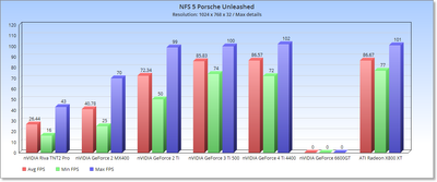

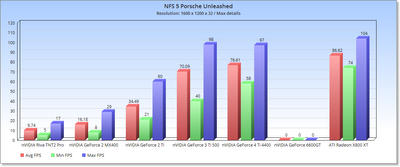

Reply 49 of 72, by bloodem
rfratelli wrote on 2021-04-05, 03:57:
Yes I've tried some older drivers (from Phil computer labs website). No luck. I wasn't using the patch in first place I just tried the patch when It did not worked out of the box.
Must be some kind of VGA compatibility issue because I remember running it under win98 back then, I just don't recall on which hardware.
Anyway, such a great game!
Your issue is without a question related to the video card. A GeForce 6200 is not suitable for a Win98 build, its drivers break compatibility with many games.
In my experience, the fastest video card that still works with NFS 5 Porsche in Win98 is the Radeon X800XT/X850XT
You don't need this video card, though, unless you want to play at very high resolutions with AA & AF. Also, it should be noted that the NFS5 frametimes are all over the place even with the fastest hardware possible (game engine limitation).
Here's some graphs that I made a few months ago (tested on a Pentium Dual Core E5800 @ 3.8 GHz). You can decide which video card is best for you, depending on the resolution you want to play at.
As it can be seen, the GeForce 6600GT did not work with this game, even when using the most compatible drivers that I could find.
