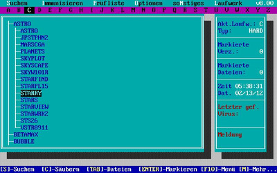

Not sure, but probably anything was better than what shipped with DOS. 😉
I believe I used Carmel Turbo Antivirus (TNT) in the 90s (knew 853 viruses).
Another cool one was on a shareware CD-ROM and had a cool virus database,
with lots of background information. It wasn't F-Prot, though, I believe.

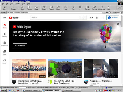

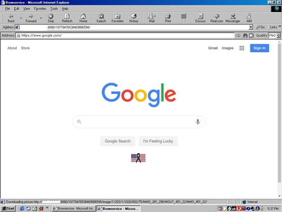

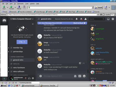

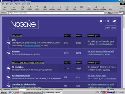

Forgive me for bumping this topic after three months, but after going each post, I think I might have found a solution for browsing the modern web on retro web browsers. I've been using this proxy on my Raspberry Pi 3 to connect to my Win98SE Dell computer via wireless connection called Browservice. It is a web proxy that uses a chromium-based browser interface and renders webpages on a client's (win98 computer) web browser using java script. From the looks of it, it looks similar to the Web Rendering Proxy (WRP) that someone mentioned in this topic earlier in that Browservice uses its own GUI on the client's browser. However, WRP used images to render web pages and required constant reloading while an action is being performed (clicking on a search bar, ect), whereas Browservice allows you to interact with the web page freely. For more information, check it out at https://github.com/ttalvitie/browservice
I have attached some screenshots of the proxy in action using IE 5.5 and Retrozilla.
There are limitations though:
  • The proxy is only supported on Linux, so you will need a raspberry pi or VM for this.
  • Audio is streamed only from the server (Raspberry Pi), not from the client. I don't think you can use the client's webcam and microphone yet.
  • Depending on the machine or internet connection, websites can be sluggish
  • File upload is not supported. You can download files though
Overall, I highly recommend this if you are looking to chat with family and friends on retro machines using Discord web, Facebook Messenger web, Instagram, and Whatsapp web. No need for IRC and third party IM clients or servers. This is also recommended if you want to download stuff for your retro machines from websites that do not load on old browsers through normal means due to HTTPS.
I would also like to add that if you want to watch videos indirectly from Youtube, try the 9xweb script as shown in https://msfn.org/board/topic/181417-windows-9 … b-helper-9xweb/
