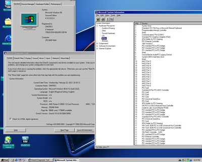

Reply 49 of 50, by OMORES
Sorry for coming late to the party. Didn't know about this "CPU issues" when I bought my Ryzen 3900X about two years ago. So... I went for a fresh install on real hardware (X470/3900X/Voodoo3) and everything worked fine in the end, as I was expecting. As of today Windows 98SE is still running perfectly stable, I can play for hours, get online etc. I encountered the same random .dll errors when I was messing with 32bit disk drivers for my PCI to SATA addon card.
Since my Ryzen 390X can run natively Windows 3.11, 95, 98 etc I would blame the VM software, VM implementation in the CPU or the BIOS.
Strange enough - on this very machine, once I upgraded the BIOS for the 5000 series - Windows 3.1 would boot and load - but exists to DOS in a few seconds. I encountered the same problem with the old BIOS and it was also disk related. Thing are worse with Windows 95, 98, Me which all give now the famous VCACHE error. As soon as I revert to the old BIOS everything works fine again.
I believe that Ryzen 5xxx series are also compatible at CPU level but the problem might be the AGESA release by AMD.
AWARD, PHOENIX are still in the BIOS business?
    141.98 KiB
    472 views

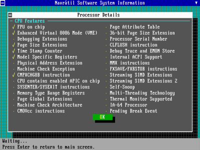

^Hi. I'm just a layman, but.. This is about VMs, I think. V86 and other CPU features should still work in Legacy mode on Ryzen (native boot).
Virtualizing them in x64 Long mode+Compatibility mode et cetera is a bit of a different story.
It adds things like Ring level -1, hardware-assisted virtualization et cetera.
https://en.wikipedia.org/wiki/X86-64#Operating_modes
That's the thing that old Ryzen messed up, among other things, maybe:
http://www.rcollins.org/ddj/Jan98/Jan98.html
http://www.rcollins.org/articles/vme1/VME_Overview.html
https://en.wikipedia.org/wiki/Virtual_8 ... ions_(VME)
Those "fixed" Ryzen CPUs maybe just dropped VME from CPU ID, they didn't fix anything.
If so, they just make software use an alternate code-path, a fallback.
Which in turn automagically seems to fix all the woes.
I think that's what early VM workarounds made use of, too.
They did overwrite CPU ID for the VM from the host side (explicitly remove VME flag in a VM's config file).
That got XP running inside the VM, at the time. Though it's notable that XP itself did the magic here, not AMD.
- Since I'm no Ryzen owner, I cannot test this, of course. So what I say is purely speculation and hypothetical. 😔
To double check, please use NSSI on Real-Mode DOS on a Ryzen PC and check CPU feature chart.
Let's please note that fallbacks for non-fully Pentium compatible CPUs were added into software way back in the 90s.
To get things running on Cyrix-like CPUs, so to say.
However, it's uncertain if those fallbacks from eons ago were ever properly tested. 🤷‍♂️
Their inclusion was more of a political decisions, maybe, than anything else.
All modern CPUs had VME, after all, including late 486 cores.
So a reliance upon their practical use is abnormal, strictly speaking.
Edited. Edited again. Formatting fixed.
    195.94 KiB
    421 views
    NSSI and a Pentium OverDrive
