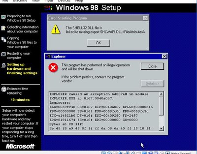

Reply 5 of 50, by marvias
in virtualbox, installation gives error with shell32.dll and explorer.exe, then it does nothing (image attached). after reset, it gives same error and does nothing again.
I found this thread with same error but no solution.
https://forums.tomshardware.com/threads/ryzen … ows-98.3361871/

Reply 6 of 50, by Srandista
For VirtualBox, it seems, that disabling Nested Paging can help. You can try that, and then find similar option in VMware. Or install version 12 as suggested on theirs forum.
https://forums.virtualbox.org/viewtopic.php?f=6&t=89230
Also, for VirtualBox there's another possible workaround:
https://forums.virtualbox.org/viewtopic.php?f … tart=15#p392728

Reply 8 of 50, by marvias
Thanks for all the links.
Disabling nested paging in VBOX really made it work fine.
And after toggling "disable 32bit disk drivers in protected mode" in safe mode in vmware VM, it started working too.

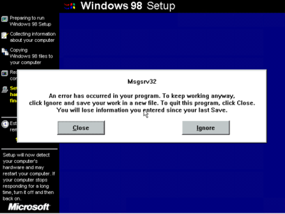

Reply 12 of 50, by marvias
in VBox, after enabling scitech display driver, I booted into "Windows protection error"
Then I masked CPUID to Pentium III S with disabled VME bit and scitech driver installed fine. I also tried to install ie6 and Unofficial SP2.1. They give errors during install.
I tried to reinstall from scratch, it spans bunch of errors that can be ignored (attached) and install continues fine after that. enabling scitech driver rendered booting into black rectangle instead of screen 🙁
well, its still not ideal.
