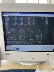

I recently bought Mortal Kombat 1+2+3 from GOG. I put 1 and 2 on my Win98SE computer. 1 works perfectly, but 2 doesn’t. The PC somehow isn’t able to allocate enough conventional memory to run it. It needs at least 512 kB of conventional memory, and at the most the PC is able to give it 490, which doesn’t display the graphics other than a few odd things (like the health bar, and the shadow of a character) after the part in the beginning where the Probe logo morphs into the MK logo. I even tried making a shortcut and giving it enough conventional memory, but I either get a message saying that I need to “unload drivers, or stop conventional memory-using apps”, or I get much less memory than I set. Is there anything I can do to get this to work? Thanks!

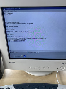

Autoexec.bat: (the first 3 lines under “c:\windows\cwcdata\cwcdos.exe“ are all 1 line)
REM [Header]
@ECHO OFF
REM [DVD-ROM Drive]
REM c:\windows\command\mscdex /d:gem001
REM [Miscellanious]
REM [Display]
REM [Sound, MIDI, or Video Capture Card]
REM [Mouse]
TShoot: @SETCLASSPATH=C:\PROGRA~1\PHOTOD~1.1\ADOBEC~1
PATH %PATH% C:\SENSEMOU
SET LMOUSE=C:\SENSEMOU
C:\SENSEMOU\MOUSE DUAL
Config.sys:
REM [Header]
REM [DVD-ROM Drive]
Device=C:\cdrom\oakcdrom.sys /d:gem001
REM [Miscellaneous]
REM [SCSI Controllers]
REM [Display]
REM [Sound, Midi, or Video Capture Card]
REM [Mouse]
REM —————————

Assuming himem.sys is where it is supposed to be on Windows 98 SE , add the following 2 lines to the beginning of config.sys :
DEVICE=C:\Windows\HIMEM.SYS DOS=HIGH,UMB
and reboot .

When I click a shortcut I made for MK2 (with 600 kB conventional memory), I get the whole “Total Conventional Memory is too high”, but when I lower it to 560 (which I can handle) The Dos4GW memory checker that runs before MK2 says I have 482. And when I run the .exe by itself, it says 490.
