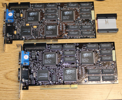

Reply 4 of 14, by andysarcade
Romain wrote on 2022-02-22, 13:18:
Hello, Are they the exact same model ? […]
Hello,
Indeed, in many cases, the same model of cards must be exactly the same (because of the personal signed eeprom by the manufacturer / dealer brand / drivers).
I had this problem by putting a Creative Labs with a Diamond (physically the same model yet).
It seems that there are mixed drivers, somewhere, but at the time I had not gone that far.
They are the exact same make/model from what i can see, apart from a slightly different colour soldermask they are the same. I did not purchase them together, i only got one of them recently but have had the other for some time.
A mismatch doesn't make sense if the setup is working in the motorhead demo and 3dmarks.

Reply 6 of 14, by RaiderOfLostVoodoo
andysarcade wrote on 2022-02-22, 15:29:
Wrong.
One has 100MHz RAM, the other 90MHz.
Reply 7 of 14, by andysarcade
RaiderOfLostVoodoo wrote on 2022-02-22, 15:46:
Wrong.
Ok, so I appear to have missed that pretty glaring fact (doh!).
So would this be considered enough of a difference between cards to break compatibility, considering they have demonstrated they do work together in demos? USing the 'mismatch' driver fast 4.6?
XT, 286, 386, 486, P200mmx, P3, P4, all the voodoos.
