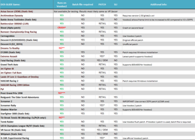

First post, by vetz
56.22 KiB
28900 views
* Retail support for V1 cards, but patch required/recommended for V2.
** Previously reported as not working on V2. I could not find a solution. If you find a way to get these games running, please post!
*** Crashes when starting a race. Manual states no Voodoo2 support.
^ Crashes with error "Out of memory for current_texture_data in setGlideTexInfo" on second level. Known error due to the game not flushing texture in video memory.
SLI=NO means that set SST_SLIDETECT=0 must be included in the batch file for the game to run if you have a SLI setup.

All tested on a socket 7 system.
I can also add that many games benefit from the increased the performance of the V2. GTA and Shadow Warrior also allows increased resolutions. The fact that you can't run one or tops two games should not stop you from using a V2 for DOS Glide games. The benefits with increased performance outweighs the drawbacks imo. Hopefully this matrix can stop all the rumours floating around that you must have a V1 for DOS Glide games.

Reply 1 of 355, by keropi
excellent! thanks for making this!
I also couldn't make Dreams To Reality work on a voodoo2 or the riva128zx... I could only use the slow software mode :x

Reply 2 of 355, by Gamecollector
Well, there is a patch for Dreams to Reality. Unfortunately I can't find english version of this patch, DE/FR only... Maybe this patch make the game compatible with a Voodoo2...
By the way, original Battlecruiser 3000 A.D. is supporting glide since version 1.07c, so you can add this game to your's list.

Reply 3 of 355, by vetz
Already tested. I've tried almost all glide2x.ovl as well as different environment settings. I get the 3DFX logo spinning, but that's it.
Patches + batch files now included in first post.
Reply 8 of 355, by vetz
Little unsure if to add this old version as it is the same game, just some iterations in patches earlier. The game is freeware now and who plays the older bug filled, unstable version with less features? I tested with 2.09 btw.
I thought EF2000 insisted on a Voodoo1?
Just add that batch file and it flies away on the Voodoo2 😉

Reply 10 of 355, by d1stortion
How many games from that list will work on V3+, roughly spoken? I recall you talking about some Voodoo3 patch for Descent in one of your videos.
Also it goes to show that Voodoo2 is a pretty damn versatile card. Still if only Windows Glide games are of concern I'd recommend a later card, because the texture trashing can be noticeable in some games.

Reply 12 of 355, by Gamecollector
Theoretically Voodoo3/4/5 are working with ALL dynamically linked DOS glide games.
In other words: all except Battle Arena Toshinden, EF2000: Tactcom, Fatal Racing/Whiplash, Starfighter 3000, UEFA CHampions League 96/97, VR Soccer '96. Looks like Dreams to Reality is the exception too.
