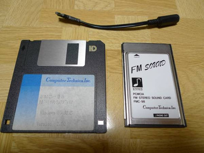

And now for something a bit different, FM and/or PCM cards only for the japanese PC-98 standard, a short review:
http://j02.nobody.jp/jto98/n_note_sound/pcmciafm.htm
Most of them use the Yamaha YMF288 chipset.

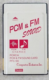

Computer Technica FMC-98 and PFC-98
35.13 KiB
1675 views
Website: https://web.archive.org/web/19990505111757/ht … it12/unit12.htm
Driver: https://web.archive.org/web/*/http://www.com- … river/fmc98.exe
Inside pictures:
https://twitter.com/Flyingharuka/status/90422 … 6139707392?s=20
14.74 KiB
1675 views
Driver: https://web.archive.org/web/*/http://www.com- … river/pfc98.exe

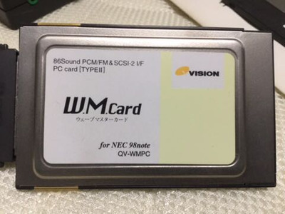

Q-Vision WM Card, Card86/Card86-R
22.16 KiB
1675 views
This is the pcmcia version of the Qvision WaveStar with SCSI https://web.archive.org/web/20010217231042/ht … oduct/wsmt.html
https://web.archive.org/web/20010217230340/ht … product/ws.html
Possible driver at: http://navitoku.jp/archive/98station/maker/qv … ware/SOUND.html

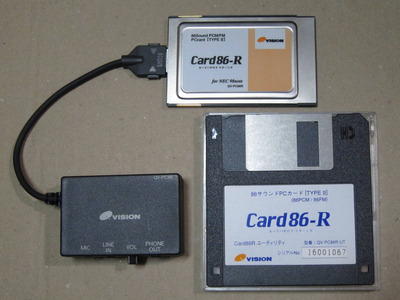

110.55 KiB
1675 views
The Card86 is similar to the WM Card but without SCSI, the R variant adds full duplex.
Website: https://web.archive.org/web/20000412032226/ht … duct/pc86r.html
Driver and enabler:
http://navitoku.jp/archive/98station/maker/qv … re/card86r.html
https://www.vector.co.jp/soft/dos/art/se253889.html

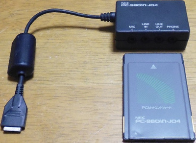

64.61 KiB
1675 views
This card is PCM only.
Specs: https://support.nec-lavie.jp/support/product/ … bod/a282-1.html
Driver: https://web.archive.org/web/19990202120715/ht … les/98_350.html

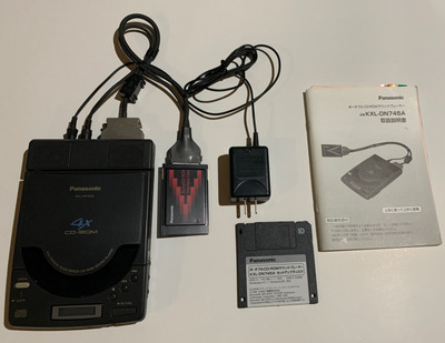

Reply 419 of 579, by bjwil1991
Won a KXL-DN745A on eBay (well, made an offer lower than the asking price) with basically all of the entails/trimmings:
183.04 KiB
1574 views
I know it's Adlib support, which my NEC laptop really needs as it only has WSS, which is only SB and no FM.
I think this is a Japanese import model (the manual and diskette have the Japanese language on it).
