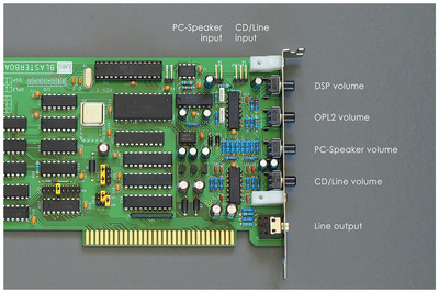

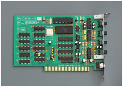

New revision G cards/kits are in stock!
Blasterboard is an ISA sound card with open-source firmware (AVR Atmega) and is software-compatible with Creative Sound Blaster 2.0. It can play 8-bit mono PCM/ADPCM samples (up to 62500 Hz), FM music via OPL2 chip and has CD/Line and PC-Speaker inputs. Each sound source has individual volume control. The audio path is very quiet (-94dB RMS) compared to the original Sound Blaster cards.
The attachment rev-g-small.jpg is no longer available
The attachment controls.jpg is no longer available
Blasterboard is available as a DIY Kit or as fully assembled and tested card:
* DIY Kit includes the PCB, a metal bracket, 2 wires for internal connection of CD-ROM/Line and a PC-Speaker and some specific analog parts: stereo output jack, Alps volume pots (3 mono and 1 stereo), 2 ferrite beads, 1 resistor network, 3.579545 MHz crystal oscillator in DIP8 package, pre-programmed Atmega MCU with the latest firmware, DIP28 plastic IC socket, MCP4901 8-bit DAC, YM3812 (OPL2) FM chip and Y3014B DAC.
--- The rest of the components are just a handful of common resistors, caps, logic ICs, etc and are not included in the kit ---
Price: 79 euros including free worldwide shipping.
* Fully assembled and tested card price is 119 euros including free worldwide shipping.
To order please send me PM or e-mail to eugenetongue@gmail.com
Current card revision is G.
Assembly manual (with full parts list), firmware and utilities:
https://github.com/labs-lv/blasterboard

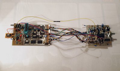

Hi!
This is a new thread dedicated to my BlasterBoard 2.0 project:
A modern Sound Blaster 2.0-compatible 8-bit ISA sound card for retro PCs.
The prototype looks like this:
The attachment P1010556.JPG is no longer available
It consists of 2 boards: DAC board (left) and OPL2 board (right).
The card supports playback of FM music and digital samples.
At this moment BlasterBoard 2.0 operates as SB2.0 in all DOS applications and games I tested it with.
Here is a short demo:
https://youtu.be/Hrpn6uMCRac
Unlike original SB2.0 card, BlasterBoard has an analog crossfader for manual
adjustment of FM music and digital sample playback levels.
Built on discreet 74HC logic, ATmega328P microcontroller, modern DAC and audio-grade
components in sound path for lowest possible noise and highest audio quality.
Done so far:
- FM music playback as Adlib (0x388) or Sound Blaster (0x2X8)
- 8-bit PCM samples playback in all modes
- Playback frequency from 4KHz to 62.5KHz
Still to be implemented:
- ADPCM playback
- Handling of sound recording commands (silent output)

Reply 14 of 555, by Scali
Very nice work!
I take it a SB Pro 2 version would not be too far off, now that you've gotten this far.
You'd need to replace the OPL2 with OPL3, and extend the DSP a bit to support stereo samples, and hook up a stereo DAC instead of a mono one, and you'd pretty much be done!
Edit: I do not see mention of any MIDI support. I take it you have not added that functionality to the DSP yet?
I don't see any MIDI/joystick connector on the card either.

Scali wrote:
Very nice work! I take it a SB Pro 2 version would not be too far off, now that you've gotten this far. You'd need to replace th […]
Very nice work!
Theoretically yes. I was thinking about SB Pro at first.
SB Pro has a mixer chip and for full playback emulation it must be implemented. It can be made using dedicated digital pots, but ATmega328P does not have enough free pins to control them. There are other ATmega chips with more pins or interface extender chips, but I want to stick to the most popular and pure ATmega328P and keep the schematics simple.
Ok, even if we skip the mixer chip and mix everything in analog as I already do in my prototype (OPL2 / DAC / CD-In / PC-Speaker - all on dedicated volume pots), there is another issue:
I'm currently implementing 4x oversampling FIR-interpolated DSP algorithm in MCU to eliminate 8-bit quantization noise, now the card has a 12-bit DAC and 8-pole analog Chebyshev LP filter @18kHz. The algorithm is pretty heavy for 8-bit ATmega and will definately not handle 2 streams of SB Pro. So let it better be mono, but upgraded audio signal than usual ringing 8-bit stereo any SB Pro clone out there can provide.
Changing OPL2 to OPL3 requires support for additional SB Pro+ FM registers 2X0-2X3, which will add even more logic ICs. It can be done on PAL or CPLD, but then BlasterBoard 2.0 will loose its simplicity of a DIY soundcard on common components.
Does anyone need a non-MPU-401 MIDI out? Or joystick port? If yes - will take it into account.
If anyone has any more questions or suggestions - please ask.
