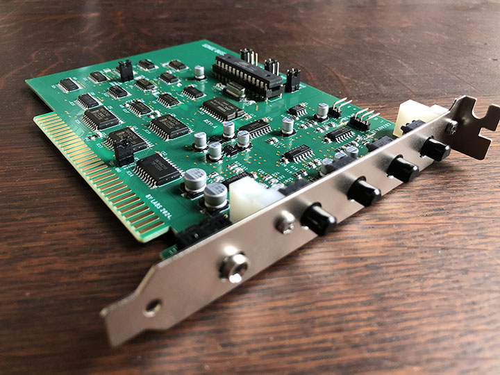

This card is my next humble attempt to design an even more compatible and simple sound card for DOS 😀
It is still a Sound Blaster 2.0 compatible, but I redesigned it from scratch, considering things I've learned from disassembled firmware of the Sound Blaster and what was impossible to implement in an already released Blasterboard without causing incompatibility hell. And it also now uses OPL3 instead of OPL2 for FM.
I decided to make it a separate project with a different name - Sonic Buster 8 (8 for 8-bit PCM)
Current state: Testing and debugging the prototype.

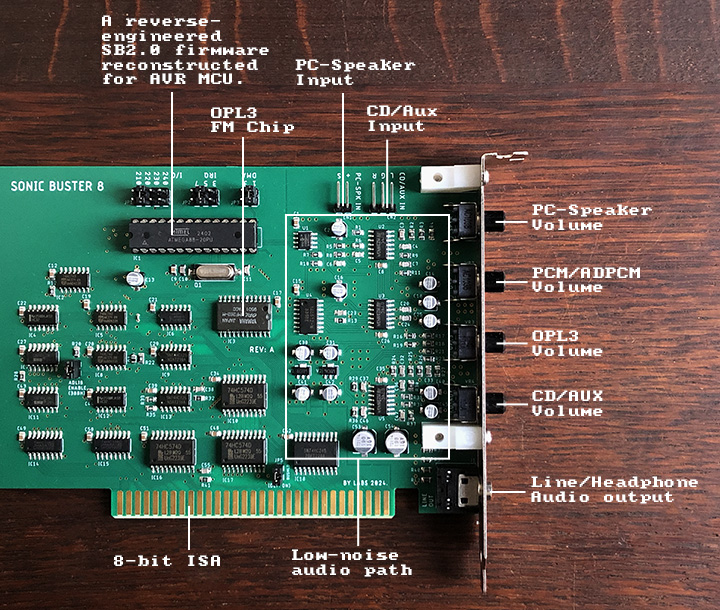

Some general features:
- Based on Atmega microcontroller
- Dead quiet analog path (-95dB RMS)
- 8-bit PCM / ADPCM mono playback
- Stereo FM music playback (OPL3)
- CD/Line stereo audio input (internal jumper)
- PC-Speaker audio input (internal jumper)
- Dedicated volume controls for all of the above
What else is added so far:
- Firmware updates using DOS utility
- Co-processor mode - uploading and executing custom code on Atmega (experimental)
- New commands for setting precise playback rate
- Up to 65535Hz PCM playback
- Far more tolerant to 486 and faster machines than the original Sound Blasters
Thanks everyone for the suggestions and reports since the release of Blasterboard! A lot of things are now implemented in SB8.

299.47 KiB
2487 views
Finally the prototypes.. and ridiculously huge stencil

Reply 6 of 41, by LABS
Not perfect, but at least there are lots of unused pcbs left from another projects to make it work
239.83 KiB
2437 views

Reply 11 of 41, by LABS
Quite marvelous I must admit 😁
351.35 KiB
2338 views
Now to the hard part - testing and debugging 🤓

Reply 15 of 41, by shevalier
LABS wrote on 2023-06-13, 21:30:
Hello,
let me introduce my humble attempt to design an even more compatible and simple sound card for DOS 😀
Wow, for the first time I see a correctly cut plane between analog and digital.
Can I whine like an old man?
- Why no via stitching?
https://resources.altium.com/ru/p/everything- … -stitching-vias
- I would recommend using combo pads.
You can solder anything on them, starting from MLСС
- I would ground the mounting bracket a little differently.
- L1 and 2 are best replaced with 1-2 ohm resistors.
Filtering is the same, but there are no uncontrolled resonances.
- V1 and 2 are better to use LM317 / 338 with a capacitor on the adj pin of 10+ uF.
With a voltage drop of 5+ volts across them, they are much better than lowdrop regulators at noise and ripple rejection.
PS. Very nice design.

Reply 16 of 41, by LABS
Thanks for your input, shevalier! I'm actually quite happy with current design with -95dB RMS noise floor which is more than enough for sound sources of such fidelity to consider the audio output as "dead quiet". However at the early stage of designing Blasterboard I already tried almost everything you mentioned. The first prototype even had 2 stages of voltage regulation to extremely reduce the PSU noise 😎
138.33 KiB
2185 views
But the real tests showed that there is no improvement compared with a single pair of 79/78L0x regs when used in such noisy environment. So I dropped that idea in favor of simpler design. What really introduced a horrible noise - was grounding the bracket because of the ground loop. Anyway the construction does not allow to ground the bracket now, as it is mounted using nylon mounts.
L1 and L2 should go away and I'll put wires here, again, in favor of simplicity - the filtering frequency is far far away from the audio spectrum and even from the TL074's bandwidth anyway, so it does not affect the noise and there are 22p caps on opamps for stability.
Interesting article on via stitches by the way 😀
Cheers, mate! 🤙
