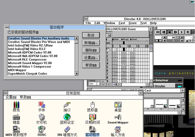

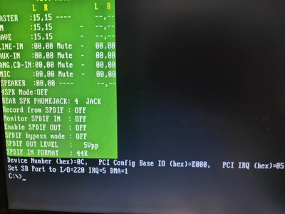

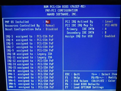

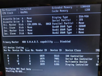

Reply 12 of 12, by pengan
I have a CMI 8738 on my ECS P6SEP-Me motherboard. I have successfully made it working with SoundBlaster 2.0 driver, both digital audio (wave playback) and MIDI (OPL emulated) works fine. I tested with Encarta '94, Macromedia Director 4.0 as well as SoundBlaster’s MIDI and Wave applications and all works fine.
First, we need some BIOS adjustment to make CMI8738 has IRQ 5 or 7, by default, my motherboard assigned IRQ 11 for CMI8738 and SB2.0 driver won't work with that, so assign IRQ10 and 11 to Legacy ISA and BIOS will assign IRQ5 to CMI8738
The attachment BIOS_IRQ.jpg is no longer available
The attachment DMI.jpg is no longer available

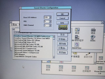

And then we need install the DOS part of CMI 8738 and Windows part of SoundBlaster 2.0 driver. I'm using CMI8738 driver found here:
https://www.philscomputerlab.com/c-media-cmi8738.html
So, we can see both PCI IRQ and SB IRQ is 5
The attachment DOS driver.jpg is no longer available
After this step, we can just use SoundBlaster 1.5 driver built in with Windows 3.1 for wave output, just like many DOSBox tutorial said. However, the SoundBlaster 1.5 driver doesn't have MIDI support, so I decide install SoundBlaster 2.0 driver.
I'm using the CT-1350B driver found here:
http://vogonsdrivers.com/getfile.php?fileid=41
The CT-1350B driver can't be installed on CMI8738 directly since the installer will report there are no SB2.0 device found, we can install it on DOSBox first, change DOSBox config file
sbtype=sb2
Then install the CT-1350B driver on DOSBox, and we got the DOSBOX_CDRIVE\SB folder which is extracted SB2.0 driver.
Copy the SB folder into the CMI8738 machine, and run INSTALL.EXE in the SB folder then we can see the Sound Blaster 2.0 install program running on the CMI8738 machine, select "Setup Windows" and install SB 2.0 driver into Windows, then we can have CMI8738 works in Windows 3.x just like a real SoundBlaster 2.0
The attachment SB20.jpg is no longer available
Updated in Dec 26, 2021
Tested with SoundBlaster Pro driver here: http://vogonsdrivers.com/getfile.php?fileid=62
And it works!
The attachment 1_1.png is no longer available
