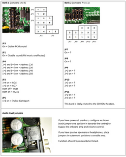

In the meantime, I've compiled what I've learned into a PDF. It's incomplete, but hopefully it helps someone in the future. Maybe someone will even find it, then come back and tell me everything I got wrong so I can update it!
EDIT: PDF now attached to first post

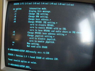

I've got this pack. ESSCFG doesn't like the card, but I guess that's a moot point as you say. ENMPU initialises without any complaints (pic 03) - but the MPU is still not visible to any other software such as games or SoftMPU. (FWIW, P330 had also been added to SET BLASTER params). Interested to see your boot config.

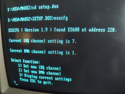

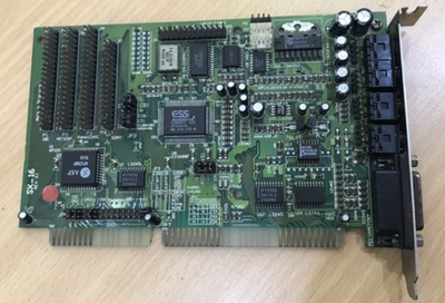

Reply 31 of 43, by appiah4
OK I checked out my 386SX. It has this card installed, jumpered as shown in photo:
Here is the system configuration for DOS:
Here is the ESSCFG output:
As you can see it responds to the ESSCFG.EXE from the Edison Gold-16 pack I mentioned above. The card is jumpered to A220, and the Joystick/IDE are also jumper controlled but I7 and D1 can be changed at boot using ESSCFG. If you do not want to load ESSCFG at boot, it automatically configures as A220 I7 D1 regardless.
It is also completely responsive and functional with ESSVOL:

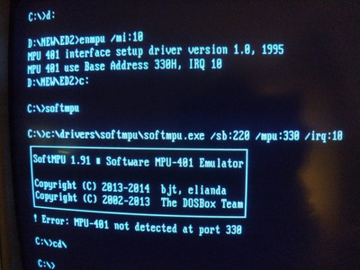

Also, I can confirm that the ENMPU TSR is not compatible with SOFTMPU, apparently. I hadn't noticed because I use a MIDI Interface Card in this system at 330 instead, but I can use devices that do not need intelligent mode on port 300 with this card.
For more information about setting up this card with ESSCFG you may want to check out thispost and this post I made to another user in another argument..

Reply 33 of 43, by gdjacobs
appiah4 wrote on 2020-06-06, 14:24:
I wonder if SoftMPU could be extended to provide the MPU401 interface directly.

Fresh eyes and the chance to bounce things off people have resulted in a little more progress on the documentation of this card. No MPU yet, but here's a thing: ESSCFG in the Edison Gold pack does recognise this card. Why didn't it before? Conflicts? Operator error? It is a mystery. But not important now.
What I did notice today, now running the Edison files, is that ESSCFG was reading a different IRQ from the card than the one I had set in Autoexec. Puzzled, I removed one of my as-yet-unidentified jumpers and ran it again. And boom, new IRQ. It turns out that two jumpers I thought were not related to each other (thanks to the janky labelling) are actually a pair, and now I know what they do. So that's all of Bank 1 accounted for.
I also spotted some jumpers I hadn't noticed before, which is pretty funny. Nestled between the two huge blue caps and the audio output, I assumed these were for line/amp switching and that turned out to be correct.
In the sequence of jumper numbers, JP6 is still missing. That's probably the MPU enable they left off at the factory <.<
(Full PDF now attached to first post)
Reply 35 of 43, by perhenden
Thanks,Pierre32, this was a huge help 😀
I'm hoping to figure out how to enable the IDE-CDROM on this card.
Regarding the block 2 jumpers, it makes sense as you say, that they control CDROM-configuration.
On my card, which looks identical , but has a sticker underneath saying "Ultra products, 12/1995", as well as empty solder pads in place of LS-212, there are labels near the CD-ROM headers.
Perhaps that's also the case with your card, I couldn't tell from the picture.
These labels say, going from card rear to card front (right to left), Sony, Mitsumi, Panasonic, and Secondary IDE.
My card has all the jumpers in block 2 set to the lower position (touching the white line), like yours.
According to Re: Where to find Jumper settings for Audio Drive ES688, which lists jumper settings for another ES688 with the same four CDROM-headers, there is a large number of potential settings to configure by jumpers.
On this card there are few jumpers, compared to that other ES688-card mentioned. We could perhaps deduce what the jumpers must represent, by considering which configuration options are required as a bare minimum.
There is no selection of IDE base address, it's always 170h, as that is indicated by the label "Secondary IDE", so that accounts for one of the "missing" jumpers.
We know that CDROM-type must be one of them. I see Sony & Mitsumi grouped together as the same setting on other cards, so at least three values to choose from are required here.
Non-IDE io base address should be one of the jumpers, given that is unpractical to have no choice here. You would need at least two values to choose between. I see some other cards given the selection of either 320 or 340.
It seems that non-IDE CDROM requires DRQ/DACK, which should have the same value, and is a DMA address (1/2/3), so that takes three values.
An IRQ is perhaps required? Or would it be possible to do without by polling the io ports? I'm guessing required.
The other card used two three-pin jumpers for non-IDE IRQ, and one for IDE. That brings us down to zero remaining jumpers.
My guess then is (using letters as I can't infer which jumpers are which):
2-pin A: IDE IRQ (14/15)
2-pin B: non-IDE io base address (320/340)
3-pin C: non-IDE DRQ/DACK (1/2/3)
3-pin D: non-IDE IRQ (9/10/11)
3-pin E: CD-ROM type (Mitsumi & Sony, Panasonic, IDE)
Hope this can be of use, perhaps for others to build upon.
I don't know how to initialize the CDROM-controller, there is perhaps a driver/sys-file I can load from config.sys?

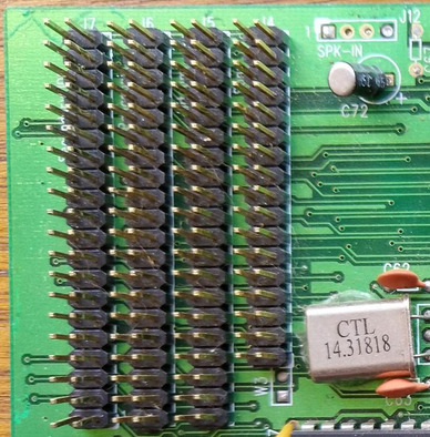

Reply 36 of 43, by Pierre32
Glad this thread has helped someone else, and that's some great additional input 😀 I've just scoured my photos and found one that shows the CD header labelling:
120.8 KiB
1666 views
Left to right:
I7 - Secondary IDE
I6 - Panasonic
I5 - Mitsumi
I4 - Sony
My card is stowed away at the moment but it will find its way on to the test bench again, because I can never let unanswered questions go. I've never tried to use the CD connectors but it would be very satisfying to at least get the IDE working with the help of the clues you've provided. And recently, Deksor has scraped soundcard-drivers.com and uploaded the lot to archive.org, so there might be some more resources to wade through:
Link Repository for Vintage PC Driver\Documentation Archives, FTPs, Websites
[edit] Curious about the lack of LS-212 chip on your card. How does it handle FM?

I just recently bought this card for a very fairly cheap price,.... so I getting this card for a Pentium 166 MMX (My lowest Retro computer in my home.. I do not own a 386 nor 486..).
I saw your card, and it is pretty much identical to what I have... (yours is "Gold-16 Rev 3.2B" written on your PCB... while mine is "SX_16 Rev 2.1").
I have attached the picture (Sorry for low quality).
I been vogons/googling research about this card, before I even post the question here.
So bear with me, if my question are "too silly"...
a. Base on your Picture, JP2 - "CLOSE ENABLE SOFTWAVE ADDRESS FOR ES1688 CHIP ONLY" . What that jumper does? what does it do?
(Because mine, it is stated "EN" and that's all. Don't know what that does...)
b. So, Since my board, is quite identical as yours, which driver do you use? I want to try to same drivers as yours, and test it.. 😀
Appreciate your feedback on this....
