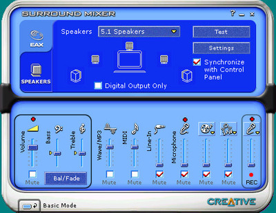

4.4 Run D:\Audio\SurMix2\Setup.exe and install Creative Surround Mixer
4.5 Start > Programs > Creative > Creative AudioHQ > Speaker and select the speaker setup that you are using, then click "Test" (in the screenshot below I'm using 5.1 speakers)
The attachment Speakers.jpg is no longer available

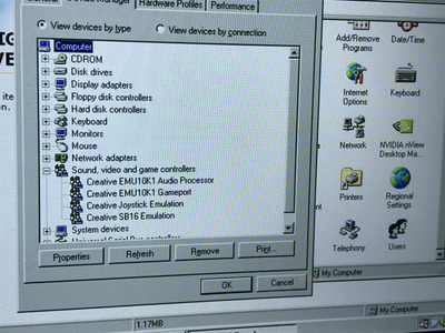

If the installation was successful, you should now have the following under Device Manager:
The attachment 002.png is no longer available

Reply 4 of 259, by boxpressed
Joseph_Joestar wrote on 2020-06-06, 06:52:
So I tried using two sound cards with this setup and it worked fine. If you go to Device Manager > Sound, video and game controllers > Creative SB16 Emulation > Properties > Resources then untick "Use automatic settings" and select "Basic Configuration 4" it will allow you to manually configure all the resources and disable port 388 (FM Synthesis) which you can then assign to your second card.
In addition, you want to disable MPU401 on your second card so that SBLive can use port 330 for General MIDI + soundfonts. Either that, or simply configure your second card to use a different port for MPU401 like 300 and you're all set. Lastly, connect the Line Out from your SBLive to the Line In of your second card and you're good to go. This way you can get genuine OPL3 and better SBPro compatibility from your second card, while retaining the SB16 compatibility and General MIDI + soundfonts from the SBLive.
I finally got around to testing this method with a CT4830 card that I couldn't get working with ANY Live! installation CD, and ...
IT WORKS PERFECTLY!
Honestly, I don't know why I'm the only other one posting in this thread. This is such a significant development, especially for people running 98SE on motherboards without an ISA slot. And it's such a great solution for people who want high-quality wavetable sound in later DOS games for the low cost of a Live! card.
It would be hard to beat a Live! + non-PNP OPL3 combo. We're talking the best of both worlds for about $30.
Thanks again for such a great guide. It was well-written and easy to follow. My Device Manager looked a little different with the CT4830, but everything works as it should.
Is it OK to delete C:\AU1 now?
The attachment IMG_9849.jpg is no longer available
