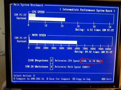

Reply 8 of 9, by BitWrangler
Here's your one free excuse ticket to upgrade to a V30, see if that makes a difference 🤣
Reply 9 of 9, by pshipkov
Thanks @Pickle.
The two cards i have on the bench at the moment don't have eeproms.
But i know what you mean - happened on other hardware.
@BitWrangler
That is already the case.
Posted about it in a another thread.
