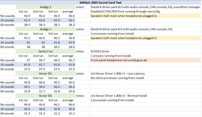

Reply 4 of 11, by ptr1ck
I spent the evening swapping cards around and ran 15 benchmarks of 3dMark03 sound tests. The Audigy 2 was the clear winner with the Santa Cruz just behind. The Xonar DG needs much more CPU, which is not surprising as it was released when Core2 was the norm.
Test system:
Athlon XP Barton @ 2315mhz
Nforce 2 Ultra
2gb DDR @ 420mhz 2.5-3-2-5
Radeon x1950 Pro AGP

Yes. Most likely with very similar results. It's just that I prefer benching actual applications used rather than artificial benchmarks, particularly one from an era notorious for drivers being written to identify the benchmark and modify behaviour for better results...
Q3A is a really good benchmark because it's so cleanly written and well-understood. I'm actually going to be using it at work in the near future for some network latency testing - in this case specifically because it doesn't have any modern workarounds for poor network performance. If your network hiccups, you instantly see it in Q3A, more so than in say Fortnite.

Great results. I doubt the age of the cards is too relevant in terms of performance, rather that the first two actually do quite a bit in hardware, where the Asus has a low-end C-Media chip that basically leaves all the processing to the CPU. I'm guessing a CMI-8378 chip from the same era as the Audigy2 and Santa Cruz would have shown similar performance.

That's pretty much what I was thinking except for I don't believe it matters if it's the low-end Xonar or high-end. I believe either one would count on offloading more to the CPU than either the Audigy or Santa Cruz.
The Serpent Rider- I wouldn't consider it trash for Windows 7 or newer; it's still a solid upgrade from latter model low-end onboard sound, like the Realtek ALC269 I have in an Optiplex 790. It is trash for a Windows XP build though. Seems like it comes down to Sensaura vs better EAX.

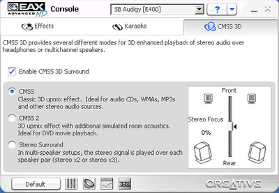

Reply 10 of 11, by Joseph_Joestar
The Serpent Rider wrote on 2022-07-12, 09:21:
Audigy 2 has positional audio (early CMSS) and EAX4 support in hardware.
You can also get CMSS2 on any Audigy card (even the first one) when using the DanielK driver pack under WinXP.
The attachment Audigy1_CMSS.jpg is no longer available
ptr1ck wrote on 2022-07-12, 15:10:
The Audigy's EAX3 is a pretty substantial upgrade from EAX2 which Sensaura uses. Especially if you're into stealth games like Splinter Cell.

Technically, it comes to two variations - Audigy CMSS or X-Fi CMSS. Practically speaking, X-Fi implementation is improved Sensaura3D in anything but name (because Creative bought them).
Well yeah, all true Audigy cards use the same DSP, with some minor tweaks.
