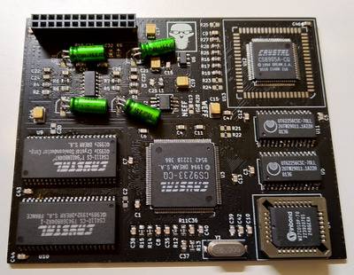

My interest for CS9233 synth began by repairing Terratec SOWT-11 watetable daughter board. I had to replace most of the main ICs to get some audio out of it, so at the same time I had to do reverse engineering. Thanks to Tiido! Eventually I had the whole schematic on my screen and decided to build it. I have some experiments ongoing how to get the best out of that chip. Of course there are also some flaws. For example big capacitors are placed and selected poorly. As I've been waiting for new PCB's I recorded this DOOM 2 END GAME track to which I can compare against later.
No high expectations.
Here's the first real recording with SB CT2940 + CS9233 WT

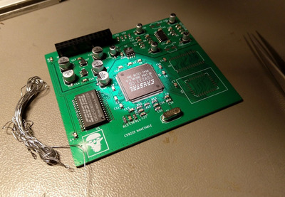

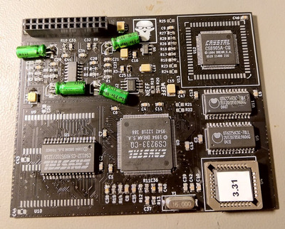

Build couple of pieces with rev2 PWB. This has options for CS8905 effect processor in two packages and 2+2MB or 1MB ROM configurations.
This revision has also "better" opamp, newer DAC and "audio grade" DC-block capacitors. Uploaded couple if DOOM 2 tracks, but haven't analysed those yet. Probably difference is close to zero. Biggest difference is that CS8905 version volume level is only half of. CS9233 mixes main synth and effect channels together multiplied by 0.5. Because there's no effects in DOOM 2 tracks the output level will be half. I amplified recordings some level but still much quieter than previous recordings.
DOOM 2 ENTRYWAY: https://on.soundcloud.com/FxMgD
DOOM 2 ENDGAME: https://on.soundcloud.com/eYqbG
I heard that 4MB ROM needs different firmware, nevertheless I had to try how it sounds. (board in the second picture) Produced "music" was strange like modern art. Some DOOM 2 tracks were still recognizable. Still that wasn't fun enough to actually record it what was my original intention. Logically next step is to find proper firmware.

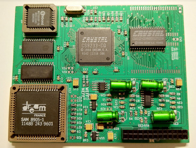

Build this "latest latest & final" rev C. I really hope it will be the final revision.
This time I used SAM8905-1 because it looks badass and I need to verify it's functionality.
According to Dream datasheet it should be the second revision issue, 64MHz. Same as Crystal CS8905A, but in different package. So it's just oversized chip doing much nothing, but looks cool.
There should be also third revision of that chip, but I've never seen one.
Everything is hand soldered in about 2 hours - headache follows.

fool wrote on 2023-01-14, 12:19:
Build this "latest latest & final" rev C. I really hope it will be the final revision. This time I used SAM8905-1 because it loo […]
According to Dream datasheet it should be the second revision issue, 64MHz. Same as Crystal CS8905A, but if different package. So it's just oversized chip doing much nothing, but looks cool.
Wow... I'm completely impressed.
It'd take me a LOT longer than 2 hours to solder all of that... and it would not have turned out that well.
Nice job!

Finally the 4MB ROM version is rocking!
Here's some very first samples that were easy to record.
(sorry about the mandatory Doom E1M1)
UFO Enemy Unknown Intro https://on.soundcloud.com/73p5A
Duke3D Lunar - Reactor E2M7 https://on.soundcloud.com/ca55E
Doom E1M1 https://on.soundcloud.com/2LhKm
Doom II Entryway https://on.soundcloud.com/sdDv4
First thoughts... It certanly more alive compared to 1MB. Some highs are a bit too loud and sounds weird...not in balance. Maybe it needs low-pass filter tuning.
But I'm glad it works after all.
