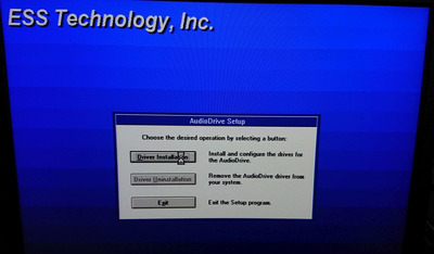

Haven't managed to get the ESS Audiodrive (ES1868) in my 486 working in Windows 3.11. Tried the drivers found on Phil's Computerlab and Vogonsdrivers without success.
The computer freezes immediately when pressing the "Driver Installation" button, see attached photo. The computer has to be hard reset, it won't respond to ctrl+alt+del.
The Audiodrive works perfectly in DOS.
Noticed that the drivers I've tried only claims Windows 3.1 compatibility, not WFW 3.11 specifically. Would surprise me if the problem was related to that, but haven't had a lot of experience with Windows 3.x the last 25 years, so won't bet my right hand on it. If it is, are there any verified working drivers for Windows 3.11 at all?

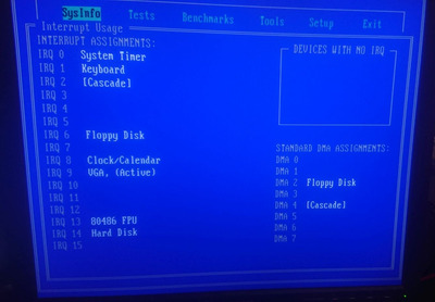

It doesn't seem to. Can't find any ISA PnP related settings in the BIOS setup, and there's the "PCI configuration setup" option, that usually is called "PCI/PnP configuration setup" on PnP enabled boards.
The "mainboard" is an SBC, IEI SSC-486H Ver C. The BIOS is Award 4.51G.
Launched CheckIt from Windows, see attached screenshot. The IRQs and DMA channels commonly used by default by sound cards are free if CheckIt can be trusted, and there's also plenty of other to choose from. I doubt it's some kind of resource conflict.
