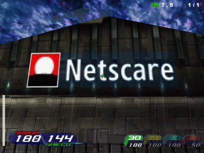

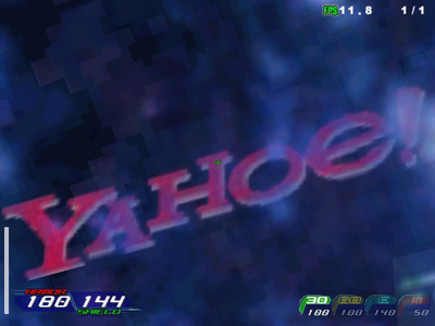

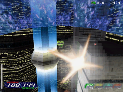

I've been wondering if some of my PCX2 non-starters are also Kyro related or driver related. like, I know i've ran Monster Truck Madness on a PCX2 a 1998 ago... and that's a first-gen Direct3D game! Since it involves engines and tires on circuits, maybe you can also look at that? 😜
Anyway, here's some amusing shots of Axis (Jamie, 2000-2001) on PCX2 (Techland SGL MiniGL)
