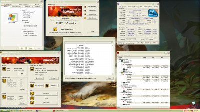

Reply 740 of 802, by Shagittarius

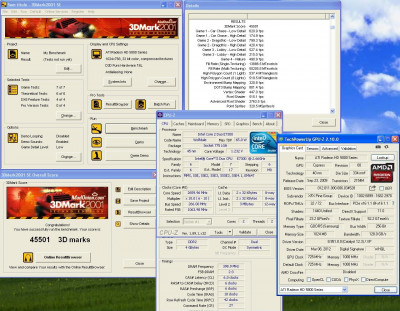

My new Win 98 Machine, scores 17k+ in 98, 22k+ in XP, here's the specs & score in XP:
Xeon 3230
ASRock 4Core-Dual-VSTA
2 GB DDR2 @533ish
ATI Radeon 9800 Pro 128MB
Windows 98SE / XPSP3
download/file.php?mode=view&id=74185

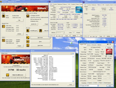

Reply 741 of 802, by SPBHM
E7300, Asrock g31m-vs, 4GB DDR2 800, XP SP3, HD 4670 DDR2, HD 5850 reference, HD 7850 windforce 2x
it's interesting how on 3dm01 the 5850 is faster even when all the specs are all lower, and on 3dmark 03 the 7850 scores a lot higher than the 5850,
the 4670 does OK given the low memory bandwidth, but it's all very CPU limited I guess, also in gaming the 4670DDR2 is way slower,

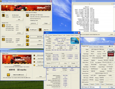

Reply 742 of 802, by Carlos S. M.
SPBHM wrote on 2020-01-11, 15:40:
ATI GCN seems to do poorly in 3DMark2001 SE compared to the older Terascale cards from what i've seem, my HD 5870 could score as high as 85k with a 4.6 ghz 1st gen i7 oc. Most GCN class GPUs struggles to surpass 45k even with really fast core 2 or 1st gen i7, for reference my 5870 scored roughly 62k in 2001 SE with an stock C2D E8600, 71k at 4 ghz and 78k at 4.4 ghz. My friend's HD 7970 only scored 45k with an i3 550 @ 3.7 ghz OC
Reply 743 of 802, by SPBHM
Carlos S. M. wrote on 2020-01-13, 09:52:
that's interesting, I wonder how much of it is just drivers "3dmark optimizations" lacking or simply DX7 optimization,
looking at the results the 7850 is also slower at GT4 which uses shaders/DX8; I would need to test other things, but this CPU is not ideal for it since both cards are really fast for a 2.6Ghz C2D
looking at 3dmark03, the 7850 scored 74K, the 5850 64.5k on the same PC; now the 7850 is faster on all tests but GT1 (DX7 but also the more CPU limited one I guess), the 5850 holds a significant lead on that but on the rest the 7850 is ahead (Dx8/9),
the 5850 is also a little faster on quake 3 arena. (but more like 5-7% and again it's so CPU limited...)

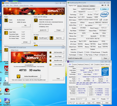

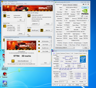

Reply 746 of 802, by Carlos S. M.
Tried on my Z97 system with i7 4790, HD 4600, BCLK OC to 103 Mhz and DDR3 2133 CL9
Also tried a 9500 GT in both single and SLI
HD 4600:
468.84 KiB
2319 views
Intel HD 4600

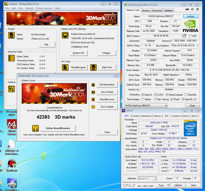

9500 GT:
469.19 KiB
2319 views
9500 GT (single)
9500 GT SLI:
475.82 KiB
2319 views
9500 GT SLI
Reply 747 of 802, by matze79
Wow SLI really Sucks.

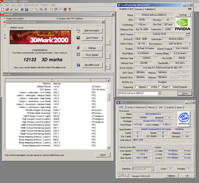

Another 5 MHz of FSB, another few hundred points. The 6800GT is slightly overclocked, at 385/540. This particular card is a pretty bad overclocker, but it's enough to push this machine over the 14K mark.
PIII-S @ 1628MHz (155MHz FSB, AGP @ 77.5MHz)
QDI Advance 12T motherboard - VIA Apollo Pro 266T chipset
2GB DDR @ 310MHz (2-2-2-5 timings)
EVGA GeForce 6800GT @ 385/540 - 81.98 driver
X-Fi Platinum
XP SP3
840.73 KiB
2261 views

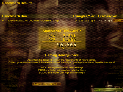

Reply 749 of 802, by Standard Def Steve
And here are the 3DMark2000 and Aquamark results. Same clocks and drivers as the 3DMark01 result up above.
100.2 KiB
2230 views
837.07 KiB
2230 views

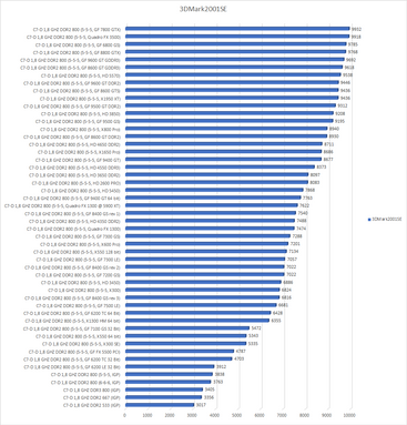

Reply 750 of 802, by Carlos S. M.
Messing with my VIA C7-D 1800 Mhz and graphing skills, there some results i've gathered at the moment, still working on it
150.1 KiB
2170 views
Reply 751 of 802, by Shagittarius
Carlos S. M. wrote on 2020-06-11, 09:03:
Those VIA chips aren't very good performers in 3d huh? I would think at that frequency you should be getting much better performance out of those cards.

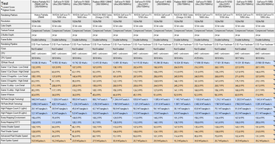

Reply 752 of 802, by agent_x007
Clock adjusted FX series (with some period cards added as ref. points) :
36.3 KiB
2101 views
GPL-2.0-or-later
Platform :
68.71 KiB
2101 views
GPL-2.0-or-later

Standard Def Steve wrote on 2020-05-10, 01:58:
Another 5 MHz of FSB, another few hundred points. The 6800GT is slightly overclocked, at 385/540. This particular card is a pret […]
X-Fi Platinum
XP SP3
Nice score 😉 Take a look at this:
CPU: PIII-S (sl6by) @ 1750MHz (166,6 MHz FSB, AGP @ 66.7 MHz!!!)
MoBo: ECSP6S5AT- SiS 635T chipset
RAM: 1GB DDR @ 310MHz (2,5-2-2-6 timings)
GPU: GeForce 6800GT @ default clocks - 81.98 driver
WIN: 98 SE
My CPU is faster, but the AGP bus is not overclocked 😉
Your RAM timings are better and your GPU is overclocked 😀

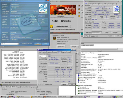

Reply 755 of 802, by Standard Def Steve
Dude! You sunk my battleship! 😜
Even though your timings are a little looser, you're pulling in some spectacular memory latency numbers there. I think mine is around 85 ns, but that could be because it's clocked a bit lower.

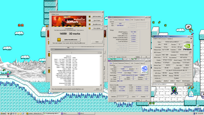

Reply 756 of 802, by VooDooMan
Haha, wait till I overclock it a little bit my friend 😉 here's the result when I OCed it to the same values as you 😜
Still The momory results will be better when I lower the timings to 2-2-2-5 :]
The next step is to run this baby at 200 MHz 😁 😁 😁
I will improve my results on WinXP later 😉
    347.48 KiB
    1759 views
Best Tualatin Motherboard
ECS P6S5AT at 166 MHz
Overclocking Pentium III
