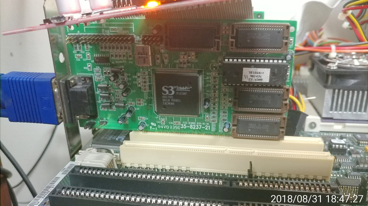

I have a Trio64V+ which is almost identical with this one pictured on vogonswiki
https://www.vogonswiki.com/images/0/03/S3_Trio64V%2B.jpg
And by almost identical I mean down to the missing extra memory chips. 😀
The main difference in my case is that none of the memory chips are soldered, the card has 4 sockets of which 2 are populated. In fact it's essentialy the same as this other card http://pcrebuilding.altervista.org/images/res … 36_p1240864.jpg but with 86c765 video chip instead of 86c767, and 2 of the sockets unpopulated.
The chips in the 2 populated sockets are 256kx16 DRAM, 50ns, FPM V53C16256HK50. I want to populate the other 2 empty sockets so I can have in WinNT4 the desktop at 1024x768 in 65k colors instead of 256 colors.
I found the same chips on ebay but they're a bit on the expensive side. I found also much cheaper chips which are pin-compatible, same organization 256kx16, same speed 50ns but they're EDO not FPM, MT4C16270DJ-5. (by less expensive I mean I can get 8 of them for less than 2 of the correct ones)
Now AFAIK EDO is "tweaked" FPM which allows for faster chaining of read cycles. IMO it should work fine as standard FPM also. I think that replacing all chips on this card with EDO chips should work. Do you think it will work?

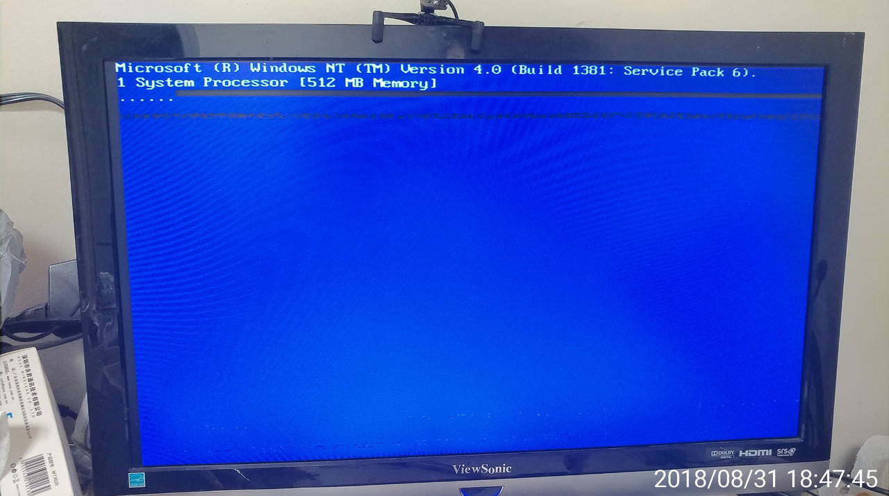

And the answer is yes, EDO memory works in this card instead of FPM. There is a bit of screen corruption but only during the loading screen of WinNT, and in fact I don't think it's related to the type of memory because it was present with the original memory chips as well.
Card with original chips:
Old chips out, new chips in:

Screen corruption while loading WinNT, which was also happening with the original chips. Image is very good everywhere else with no corruption:

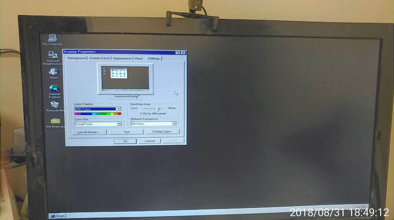

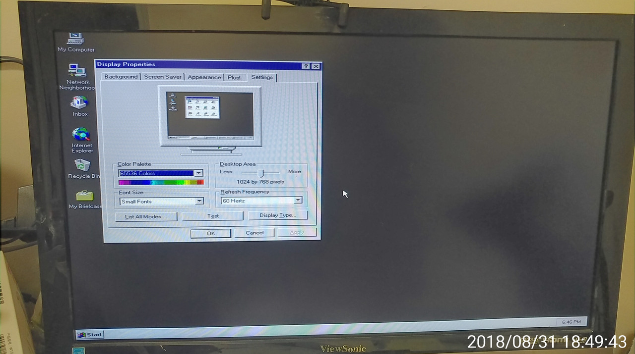

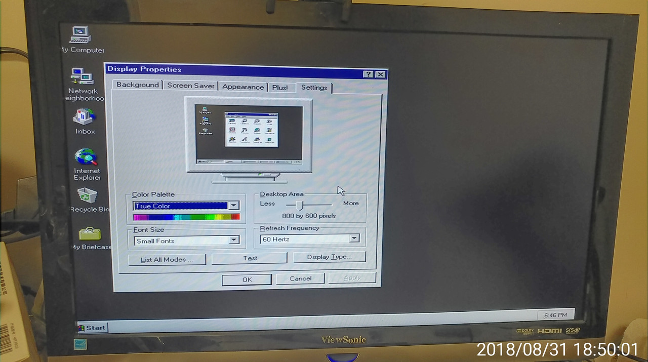

New modes unlocked: 1152x864x256, 1024x768x64k, 800x600xtrue color (1280x1024x256 kinda works too but is desynced vertically, the bottom desktop bar is halfway up the screen and I can't correct it):
Overall I'm happy with this.
