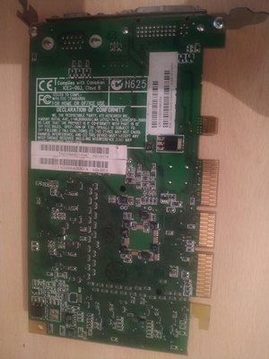

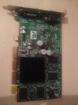

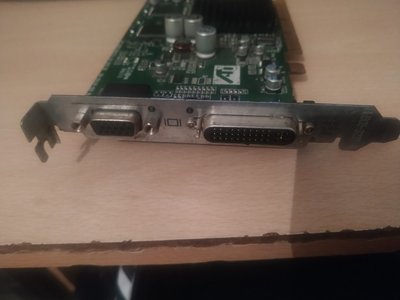

First post, by ala_borbe
hi guys and girls
it my first post here, so i hope i made it in right section
i got i retro bargain that i could not miss... i got myself Radeon 7500 DDR but its MAC edition of card... for 4euro yyyyeeeeeyyyyy
is there any option to convert this to PC? it bees if i just insert it in pc and gives no image, as expected...
i found two opposite guides (converting pc card to mac) but for different, newer cards like 9600 and 9800
http://thomas.perrier.name/otherStuff/ati9800convertEN.html
https://web.archive.org/web/20050512081415/http://www.techseekers.net/modules.php?name=Reviews&rop=showcontent&id=71
is there any sense to try this and has anyone tried something like this before? do you maybe have a dump of radeon 7500 ddr bios for pc version?
thanks in advance and i hope i did not brake any rules

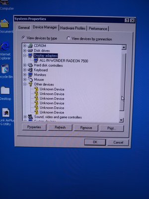

Reply 5 of 12, by ala_borbe
pfff, situation almost got out of hand... i decided to desolder eprom chip (ST25P10V6) and program it with new bios
so i backup mac bios, erased, and programmed and bam, there was an error
took old broken hard drive (WD80gb) and found another 25p10 and programmed it with bios posted here...
not that Dell, it was the other one
to my surprise, card booted... installed driver from ati and in device manager it says all-in-wander???? WTF???
so i started digging on the net and found a bunch of dumps but only few with Samsung DDR ram... most of theme are Hynix branded
i will have to play around with it to find best matched bios... i found spec on the net
https://www.techpowerup.com/gpu-specs/radeon- … ac-edition.c646
gpu: 260mhz mem: 180mhz (360 effective ddr)... but other cards have wildly different specs
the game continues tonight... will update
in meantime here are 2 big repositories of bios roms not found on TechPowerUP
http://halentech.czweb.org/biosy/biosy_main.htm
and
http://radeon.ru/downloads/bios/
will post update soon...
Reply 6 of 12, by Doornkaat
The TechPowerUp BIOS is for the AIW version so it's no wonder that's what's displayed. 😁
The one from http://halentech.czweb.org/biosy/biosy_main.htm looks promising though. Or you go ahead and extract the BIOS from your existing 7500. 😉
Anyway I'm looking forward to that update! 😀

Reply 10 of 12, by Byrd
Before you spend more time on this, this is a reference/OEM Apple Radeon 7500 which conforms to a non-standard AGP pinout owing to it supporting the 25V Apple Display Connector (ADC). You won't get it working on a PC without some pin modification.
https://en.wikipedia.org/wiki/Apple_Display_Connector
Reply 11 of 12, by Doornkaat
I think you might have misread the article. The Apple Display Connector gets power through the card. The card gets the power from the small extra tab between AGP connector and slot bracket. This generates problems when using the card in another Mac. As long as you're not planning on using this feature the card will work on PC with a PC BIOS. ala_borbe has already got his card working.
There may be issues with AGP pin A3 and A11 when using this card in an AGP3.0 compliant board. Those pins are used to indicate AGP3.0 compliance but since they're probably not grounded on the card I don't think anything will happen. Still a thing to keep in mind.

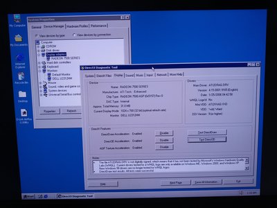

Reply 12 of 12, by ala_borbe
well, after few days, its done... well, i consider it done, with your help ofc
it works, and it works well... i think this is by far the best video quality i have ever seen... on my dell U2312HM (23.5 inch IPS panel) with vga cable... its crisp clear
after like a thousand flashes i finally found bios that works besides all-in-wonder one from techpowerup (that bios had some more unknown devices in device manager and see my monitor as non-plug-and play generic)
eventually used bios form radeon 7500 pci... its the only one that works right, although it downclocked in comparison to mine card
spec for mac are 260core / 180mem... this bios runs at 250core / 200mem and has no artifacts or any other problems... and card is not very warm after many testing with 3d mark and quake2
so i found some bios editor and added some speed to reach stock speed and i left ram as is (now its 260core / 200mem)
say what you want, this card is crazy... in quake2 opengl 1600*1200 it has 80fps... vsync-off...
3dmark score is not very special but we know that already... maybe i can overclock it more if i fit some heatsinks on ram and fan on gpu...
by the way, do you have any OC utility that works on Win98 for this card?
i dumped MAC bios with eprom programmer tool and will attach it here for sake of backup or maybe someone will try to do opposite
