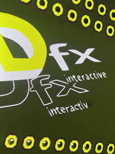

ty 😀
Check out the ‘e’
Gonna take a lot of work, but I can make the shadow a proper shadow in the copper layer using keep out zones.
I’ll update the previous post with the logo update via post edit.

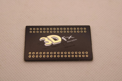

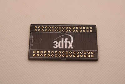

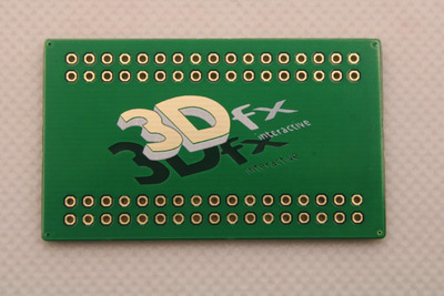

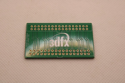

Took a little longer since I forgot to choose ENIG for the first PCBs and ordered again. Here's how they look:
97.95 KiB
1267 views
102.46 KiB
1267 views
83.4 KiB
1267 views
86.82 KiB
1267 views
The logo looks way better in person than in the photos.
As a couple of suggestions:
-remove the 4 vias in the corners as they serve no purpose and just ruin the aesthetics a bit
-the traces should be less wide, especially L2 signal traces, as they are sandwiched between ground planes, the impedance will be very low, I'd just place all the signals on the bottom layer and have L3 as ground reference.
